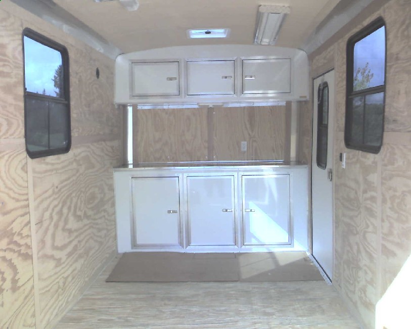

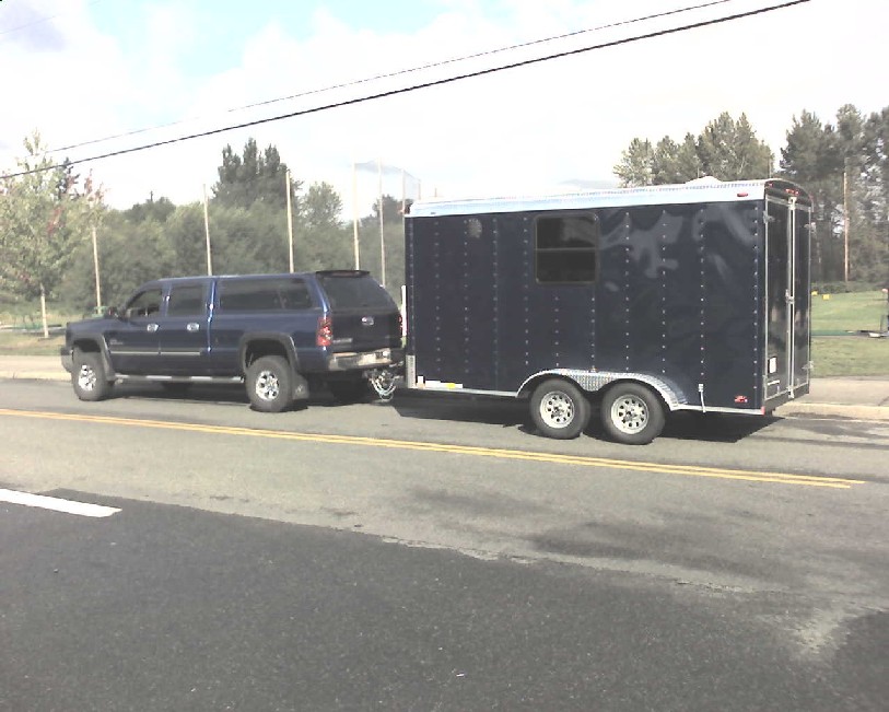

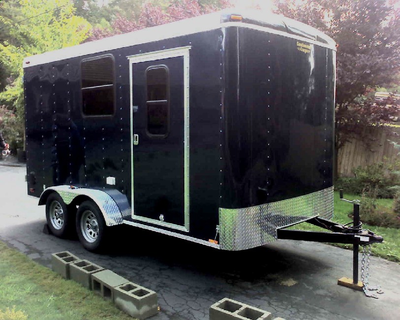

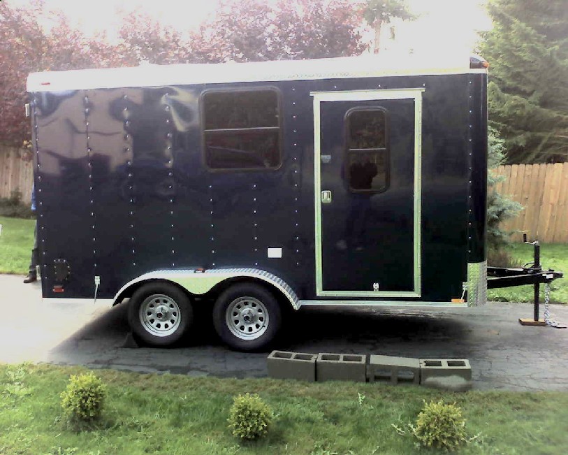

Finally the beast lives. The core and shell was picked up as planned and it rocks. Earlier this week, stereo, amp, speakers, CB, antennea's, inverter, second battery, additional 12volt plugs, Maxx Air Vents, fire extinguishers and other required nesssesities were installed and this weekend, dual folding twin mattresses go in, vinyl or laminate flooring and then coat/hat hangers, privacy curtain rod, etc. all go in.
Shortly after Christmas, chair rail, baseboards, crown molding and the walls all get painted. We are really excited and just jacked it's here & well under way....Deer season starts in 13 days not that I'm counting and elk later October.

Mine is a 7' X 14' cargo that I added 12'' of height to and I had it fully insulated at the factory along with custom cabinets built out of high grade aluminum. The interior dimensions after all that are now 12' of interior length and 6'9'' of side-to-side space. Originally I was going to build out a queen bed in the rear that folded up against the wall when I either wanted more interior use for lounging or using the trailer for cargo use. The queen was too large at 6'8'' long and 5' wide. If we ran it length wise side to side in the trailer, there was not enough room for a XL Cot to open up or another twin bed built in the front with the cabinet doors opening. That all being said, I went with a twin mattress that is 6'2'' long and 3'3'' wide. We are building a folding bed on the RV door side out of 3/4 AC plywood and 2"x6" hinged legs. It will be hinged to the wall with a solid aluminum handle on the bottom for lifting then a matching gate latch at the top to hold it in place out of matching metal / aluminum. I am not too concerned with weight of the trailer as I am 6'2'' & 240 lbs and I built this to be a stout hauler & started with dual 3500 lb axels and have the horsepower and efficiencies to pull it. My Duramax is getting 24 HWY and 16+ towing depending my mood to throttle it up and get to where I’m going. It’s a maturity thing I’m sure but some things are just worth spending a couple of bucks on……there’s something to be said for slinging past SUV’s cresting an alpine mountain pass getting better mileage and doing the speed limit while under tow. 8)
I will have updated pictures of the electronics and bed around Monday of next week. The Stereo and speakers are amazing as is our power runs for everything.
