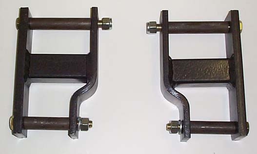

Can you go with a taller tire? Do you have the wheelwell clearance? You could have some spring shackles made to lift it. You could have the springs re-arched or replace them, depending on their condition.
If you have shackles made, build them like this. (yours probably doesn't need the bend, just an example) The center spreader bar holds the side plates to keep them from scissoring.
