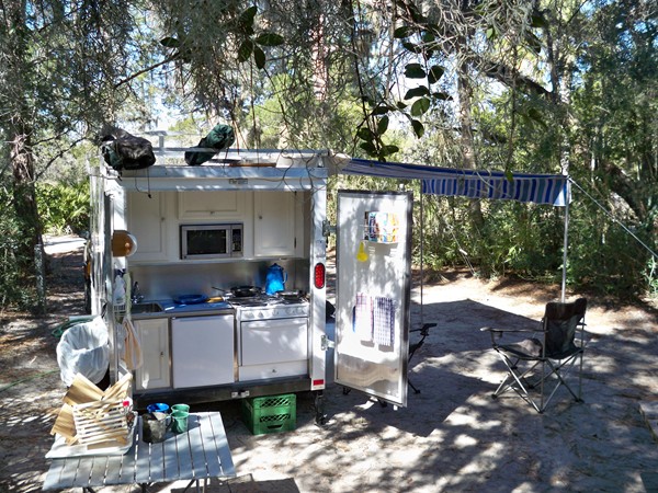

Postby John Boeckstiegel » Tue Feb 10, 2009 8:22 pm
Xrover,
Thought I might share my 5x8 v-nose conversion. Maybe this would help.
The counter is the same from the ground as a counter in your kitchen. I have a 16 gallon water tank under the inside floor. Our maiden voyage was this weekend. It was great.
John Boeckstiegel
Posts: 64
Images: 64
Joined: Thu Nov 20, 2008 10:40 pm
Location: Jacksonville, Fl.

Postby John Boeckstiegel » Wed Feb 18, 2009 7:30 pm
I just came back from a 30Degree night camping trip. It was plenty warm. I took the whole interior down then put 3/4 sytro, then rebuilt the interior. The floor has been raise 12" for storage so the air space under the matress keeps us warm. A very small heater did the trick.
