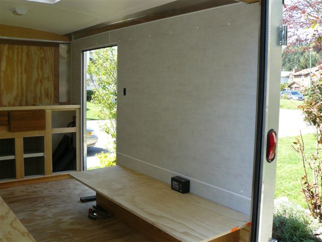

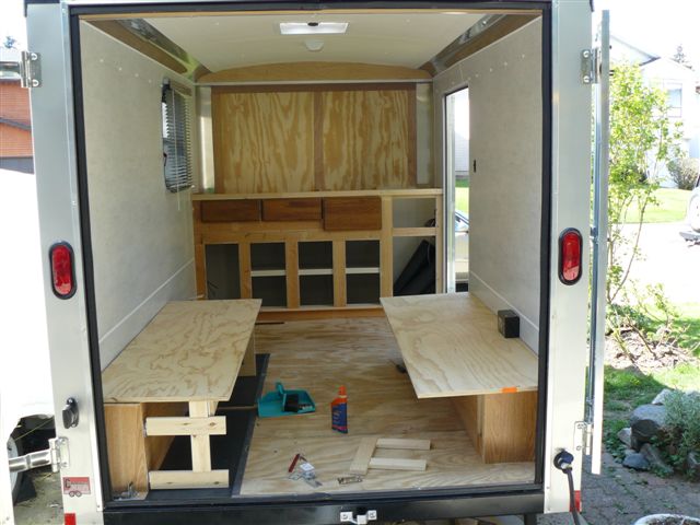

I have installed the side paneling
41willys
Posts: 29
Images: 44
Joined: Mon Mar 23, 2009 12:01 am
Location: vancouver BC Canada

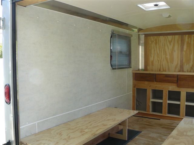

Postby 41willys » Tue Apr 28, 2009 11:21 pm
other side
rear view

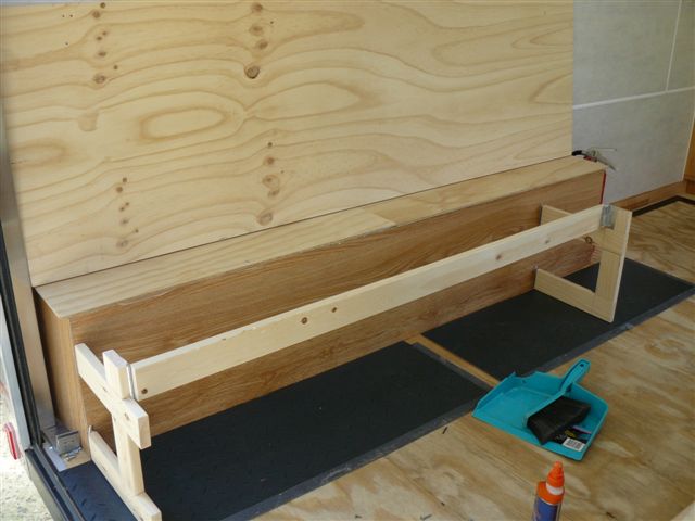

window side

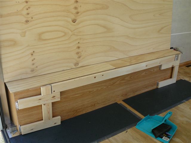

fold away seat support "out"
fold away seat support back in place.
seat base in place

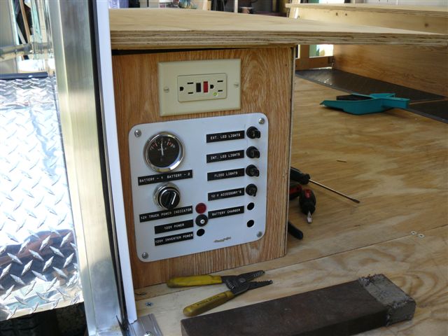

[img]http://www.tnttt.com/gallery/image.php?image_id=49492][/img]
power panel installed and wired up.

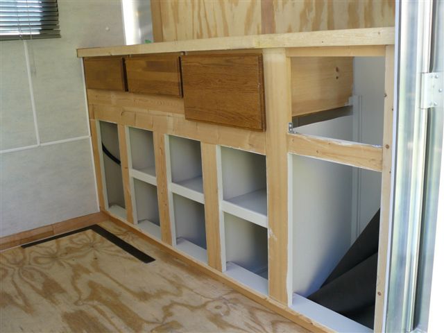

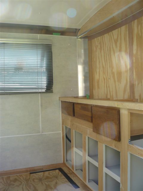

Postby 41willys » Tue Apr 28, 2009 11:38 pm
shelving now in cabnets

Postby hunter535 » Wed Apr 29, 2009 5:26 am
41 willys,
That is looking really sweet :thumbsup:
I like the seats and the cabinets in front. What is your wall sheathing? That is nice looking as well!

Postby 41willys » Wed Apr 29, 2009 7:47 am
Thanks for the comments, the wall covering is a 4 x8 sheet of paneling i found at a local hardware store that is covered with a textured paper that is mostly white with splashes of blue/gray and a little red in it. I used contactors glue in a tube to put it on with, would not do that again the glue is great for 100% contact bonding but this was far from that. Due to the wall being curved I could not force the sheet against the wall everyware. I would use some kind of silicone / glue next time. it has worked but not 100% happy.
The seats have been a healthy debate with the wife! so far Im winning which means the seat cushons will be attached to the plywood base. two base seats and two back supports this will allow for me to rotate the pieces into a bed accross the flip out support.
