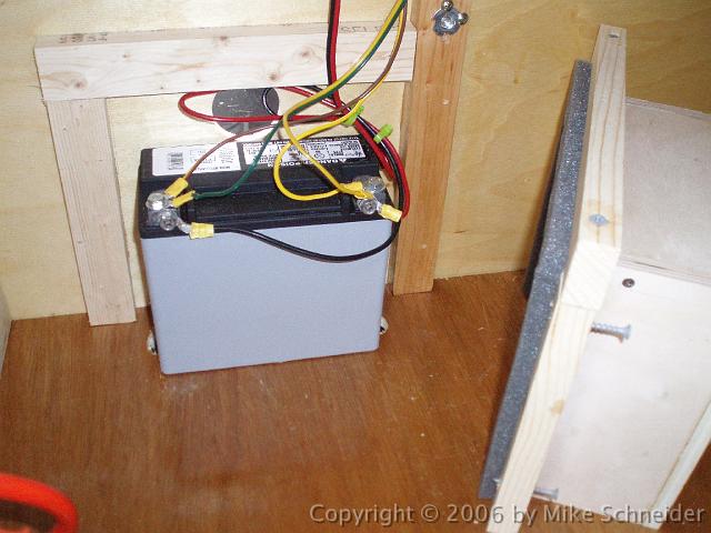

Postby mikeschn » Wed May 13, 2009 5:25 pm
I would grab an AGM motorcycle battery. Small, light, and no fumes, or so they say. If all you need it for is lights, it should last all weekend without a problem.
It probably wasn't necessary, but I put a hole in the floor and in the sidewall, just in case.
mike...
