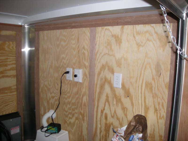

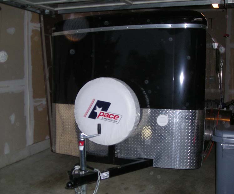

Hi everyone. I'm still thinking about installing an AC window unit in my trailer. The only reasonable place I can think of to mount it, without taking up interior space by building bulkheads or boxes with ducting, is to mount it in the front wall of the trailer, high up, so that the bulk of the unit clears the front tongue-mount spare tire.
Of course, putting it there means I need to rethink my upper cabinet plans.
Questions, please:
1. Can an AC-sized square hole be cut into the front wall of the trailer, without compromising its strength and rigidity?
2. Let's say I measure the AC, and cut a hole that size. How would I permanently support the unit? I can't imagine the front bulkhead of the trailer is strong enough -- it's just 3/8" plywood, insulation and outer aluminum shell.

Reinforcing the wall with steel wouldn't be difficult. I put a 5000 btu in mine that only weighs 39 pounds so it didn't take a lot of metal to hold it.
I really, really, really hate the idea of cutting a hole in the front of a trailer. Driving down the road at 60 mph in a rain storm tends to drive water into even the smallest of voids. Most RV manufactures stopped putting front windows in their units because of the high percentage of leaks. I've spent hundreds of hours repairing water damage due to leaks in the front of campers.
I'm assuming you don't want a roof top air because it wont fit in your garage?

edcasey wrote:I really, really, really hate the idea of cutting a hole in the front of a trailer. Driving down the road at 60 mph in a rain storm tends to drive water into even the smallest of voids. Most RV manufactures stopped putting front windows in their units because of the high percentage of leaks. I've spent hundreds of hours repairing water damage due to leaks in the front of campers.
Thanks Ed; he is soooo right. I did not consider what would happen while driving -- so mounting the AC there is not an option. And yes, can't put it on the roof because of the garage height limitation. If it weren't for that, I would have ordered it from the factory that way.
DrCurran: Would mounting it at the floorline make for a circulation problem with cold air staying down near it? But even if hidden from the windstream by the fender, I would think you'd still have a problem with splash and rain while underway.
