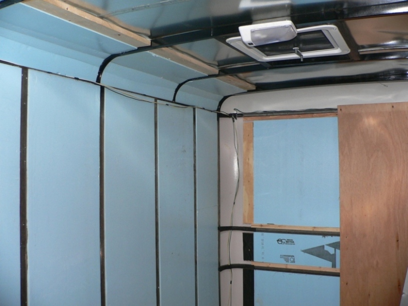

I am with steveb. The studs in my CT are 1" square steel tube thus the 1'' Dow Super Tuff-R insulation fit perfect. I cut to fit, pushed in place and covered with luan for now. This stuff was a bit pricey but I figured that I am only doing this insulation thing once in this trailer so I don't want to skimp!

Postby Nitroxjunkie71 » Sun Aug 16, 2009 6:20 am
I also used the Dow 4x8 sheets. It keeps it warm inside. I insulated my barn doors finally this past Jan and the draft went away.
And it is very easy to work with. :thumbsup:

Postby Nitroxjunkie71 » Sun Aug 16, 2009 6:43 am
devigata wrote:How did you work it around the curved part of the ceiling?
Well................ I didn't. :oops:
I still have not gotten to that yet. I have only used the trailer one time in the winter, and summer camping is not as hot as what you are probably used to. I really like what Kevin57 did with his
and have been lurking around a bit to get ideas. With life comes priorities and that is not very high on the list but I will get to it eventually. :thumbsup:
There is a 5X8 cargo on here that used the 1" 4X8 dow simply by scoring it on one side so it would bend. It seemed to work nicely.

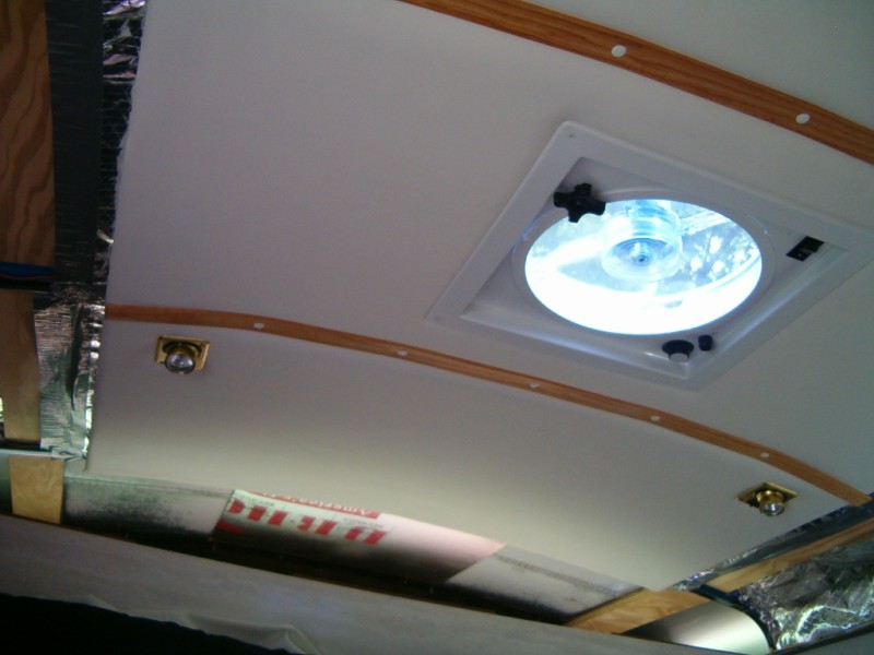

Postby kevin57 » Mon Aug 17, 2009 8:07 am
Here's a pic of the finished ceiling.

Postby Nitroxjunkie71 » Tue Aug 18, 2009 2:13 am
kevin57 wrote:Here's a pic of the finished ceiling.
:oops: I guess I could have dug around a little better for a photo of the ceiling finished :oops: BTW, it looks great! :thumbsup:
