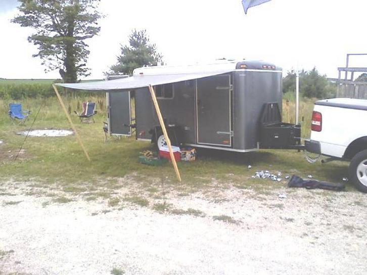

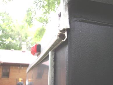

I was at Fort Wayne with Jeff "Nitroxjunkie" when someone pointed out how lucky he was to have a c shaped trim channel on his trailer and showed him how to take advantage of it.
With the use of a simple and inexpensive tarp you can have a wonderful front porch for what ever use you wish.
These are early pictures while in the experimental stages
Our last outing he had purchased some nice aluminum telescopic poles and it looks factory as factory can be.
The tarp is simply doubled over and a fiberglass 1/4 rod is inserted into the fold and guided down the channel." 6 foot fiberglass survey stakes can be found at most farm type store"
So you might look at the drip edge on your trailer you might be one of the lucky one that have this feature already built in.

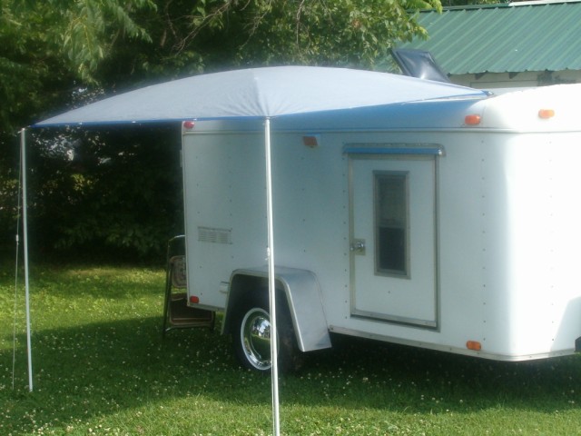

Here's how I got the sag out of mine . I used some fiberglass poles from an old tent and ran them from corner to corner.
So far it's held up under 20 mph winds.

Postby Twinsteel » Fri Aug 28, 2009 6:53 pm
Great idea for an ultralight awning! Anybody know if this type of aluminum channel can be purchased by itself to add to a trailer?

Postby tinksdad » Fri Aug 28, 2009 7:38 pm
Twinsteel wrote:Great idea for an ultralight awning! Anybody know if this type of aluminum channel can be purchased by itself to add to a trailer?
Yep!! I did a quick Google for awning rail and this is just the first of many that came up that sell it.
http://www.campersdirect.com/restless/details.php?ITEM=4923014

Postby len19070 » Fri Aug 28, 2009 7:56 pm
Any, and I do mean any Local RV dealer has miles of it that is just plain left over.
Every new awning, slide topper or window awning comes with a piece of awning rail.
And 80% of all coaches already have it mounted to the coach.
Don't let them BS you.
A $10 or $20 dollar bill will get you all you need for the next 10 years.

Postby Nitroxjunkie71 » Fri Aug 28, 2009 9:18 pm
Thanks Bob for starting this thread. I have been meaning to do so but don't get on here much in the summer. I would not have had a clue if a fellow camper had not brought the C channel to my attention. I did some checking and an eBayer was selling plans for an inexpensive awning using this channel and that is where the 2X2's came into play (for testing). :thinking: Once I figured it out it was golden!
hunter535 wrote:That is a good idea. :thumbsup:
I have also seen some use rope in place of fiberglass rods. Just wrap the tarp tight around the rope and feed it through. Usually requires two people to do this though.
Hunter, I have heard that using rope is also an option. I had some driveway reflectors laying around so I popped off the reflectors and used the shafts and they worked great. It can be done with one person but two definitely makes the job easier. I heard these tracks are used for bag awnings. Does anyone know if this is the case?

That's the idea that we have to use the old tent poles. Instead of "plain" legs, we will use the extendable ones from the broken EZUp we got out of the neighbor's trash. Not sure if we will mount them to the ramp itself or just put them on the ground.
Kevin, how did you attach the shock-corded tent poles to your side poles?

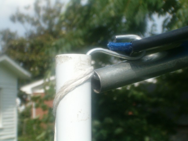

Postby kevin57 » Sat Aug 29, 2009 9:29 am
Cathy Jo
I drilled a hole in the top of the pole and the fiberglass pole slips onto a S hook.
There's more pics on page 2 of my album.
Kevin

Postby Todah Tear » Thu Sep 10, 2009 9:10 pm
Kevin,
Does the tarp just rest on top of the fiberglass poles? It kind of looks like the poles are attached tod the tarp. If they are how did you do that?
Todah
Todah Tear
Posts: 1723
Images: 282
Location: Texas
Postby kevin57 » Fri Sep 11, 2009 3:13 pm
Todah
I used the velcro loops and center tie from the old tent, and S hooks on the corners.
