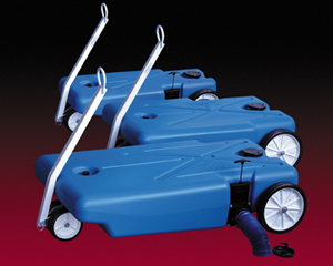

Postby jeep9806 » Fri Sep 04, 2009 12:27 pm
This is what we use while camping at a place with no sewer hookup at the site...
Todd
