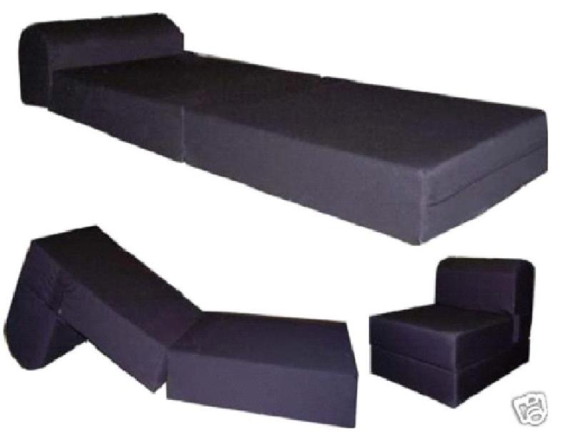

Postby hausfrau60 » Tue Oct 20, 2009 11:25 pm
Or ... folding beds. I'm considering getting two twins that will fold up under the cabinets during transport.
Image[/img]
