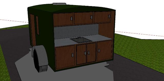

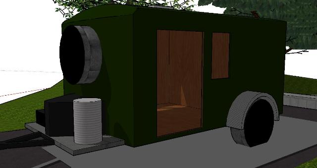

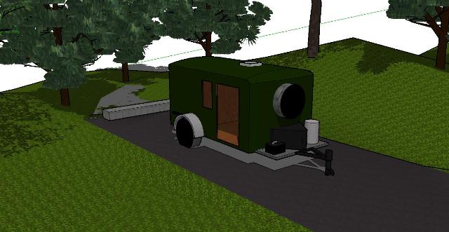

My son just finished the initial 3d version of our cargo conversion. Doesn't have the doors or windows put on yet or the interior cabinetry, but the general ideas are there and I think he did a great job! I'm making a list of what I want the trailer manufacturer to include when we order it next week. Anything over my budget will have to be done over the winter, little by little. But I hope to get the majority of the structural stuff done before it hits the garage, with just the interior work left.

I am assuming double cargo type doors at the galley?
You might be able to French cleat a couple of counters to them after you open them up for more usable space.

I'm not sure there's going to be the room on the tongue that you envision -- on mine there would be barely enough room for a tongue box and/or propane tank mount. I ordered the factory-mount spare tire and Pace mounted it in the middle of the tongue with welded box beams thereby killing all the available space. And structurally the side windows might need a larger space between them and the doors to work.
Do you think you might have a refrig, or are you thinking large cooler? If cooler, you might need to leave a space for it to slide into the galley.
That's a big sink you have there. If you were to move it to one side, it would maximize the counter space available for prep work, or a camp stove, or a microwave...

Yes, there will be two rear doors. We're ordering a longer tongue, but I'm not sure yet how everything will fit. If we can get all that on there, that would be the plan. I would like to see the spare mounted in the front as shown.
The kitchen will have a Camp Chef Stove/oven on a slider on the left where I'm having a propane stub line installed underneath from the tongue area where the tank will be mounted. A 15 gallon water tank mounted below, a gravity-fill and city water inlet on the back side (just like the tent trailer had). The sink is 17" wide by 22" long and 5" deep. On the right will be another slide-out for a large cooler. And, yes, some kind of fold-down counter situation on both doors. If I can figure how to do it, I'd like to add a portable on-demand water heater (Camp Chef Triton Hot Water on Demand). They're also installing the 110 system and 12 volt. I'm fuzzy on what to ask for there (just want lights, a ceiling fan, and a couple of plug-ins in the cabin for radio, fan, heater, cell-phone chargers, etc.). In the galley, I'd like to see a couple of plug-ins for coffee pot, toaster, etc.). They're also insulating walls, ceiling, and floor.
Any help with these details would be very appreciated. One thing I was worried about was the weight of the kitchen on the back. We're having stab jacks installed on all four corners, but if the cabin is empty, will the long tongue with propane tank and battery be enough to prevent it from tipping back? It seems like the placement of the axle would prevent that, but I want to be sure.
