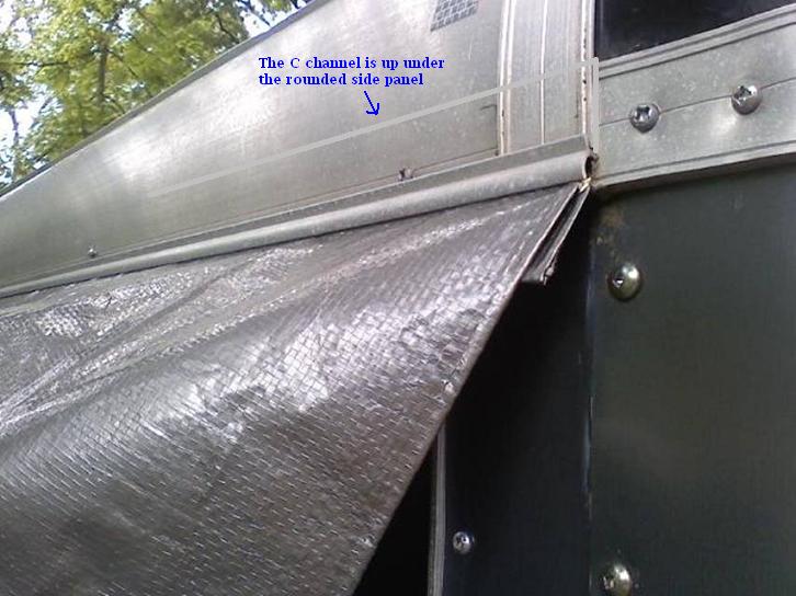

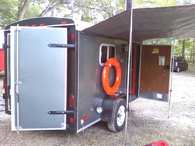

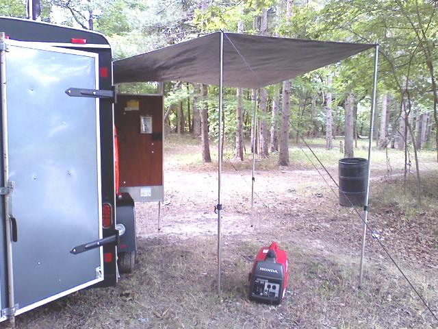

I plan to put an awning along the side as well as over my rear ramp. I noticed in your pics that you have the same problem I do in that there is very limited clearance between the top of the side door and your tarp. I'm going to copy your idea of extra poles to support the tarp.

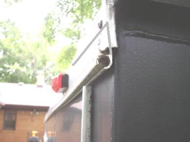

I have to remove the generic trim that covers the intersection between the roof and side material and install "C" channel. I was thinking that if I install the channel with the "C" facing up instead of down, as is usually done, it might give me an inch or so more clearance on the door. Opinions, anyone?

SmilinJack wrote:I noticed in your pics that you have the same problem I do in that there is very limited clearance between the top of the side door and your tarp.
Yes the tarp is low because of the smaller trailer. I know my dads larger trailer would have plenty of room to extend one straight out with no problem but some additional support would still be necessary to help eliminate some of the sag when it rain's by either using some additional poles (like I have done) or by using some fiberglass tent poles like Kevin57 did. Very good idea
Kevin57 wrote:Here's how I got the sag out of mine . I used some fiberglass poles from an old tent and ran them from corner to corner.
It doesn't hurt anything with the tarp up like I have it. I just lower the tongue a bit and let it rain. The C channel adds a natural water channel so no water intrusion takes place.
SmilinJack wrote:I have to remove the generic trim that covers the intersection between the roof and side material and install "C" channel. I was thinking that if I install the channel with the "C" facing up instead of down, as is usually done, it might give me an inch or so more clearance on the door. Opinions, anyone?
It would be hard for me to say really without seeing the trailer. With my application I would say no because you would loose your seal but on the flat tops others would have to add their two cents who are familiar with that style.
