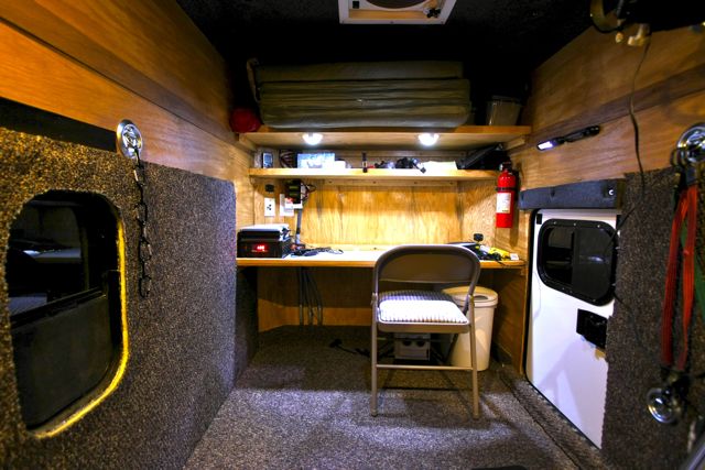

I built a desk up front for the laptops. All the lighting is LED and I have both white and red so
I can preserve my night vision. I put several 12 volt power outlets inside and a couple of
power outlets outside to support my astronomy mounts. I put a couple of shelves above the
desk to store a fold up mattress and other stuff.

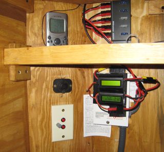

I want to keep track of my power usage so I put in a couple of Doc Wattson amp/volt meters.
One tracks the load on the battery and the other tracks the solar panel input to the charge controller.
Here's a picture of the meters on top of the charge controller. I also have a knob to
adjust the fan speed and a couple of reset switches for the meters.

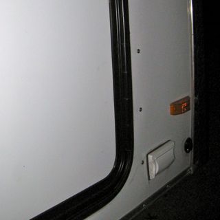

Here's a picture of my cable access hatch and 12 volt power outlet. I use the hatch to
feed the USB cables to my mount and cameras. The DC power outlet feeds the equipment.

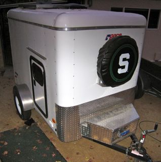

The trailers a bit heavy on the tongue and don't want to put more weight in front. I got some
feedback regarding mounting the tank in the general forum. I think I will move the spare tire
to the side of the trailer back behind the fender and mount the propane tank up above the tongue box.

Postby astrotrailer » Sat Nov 14, 2009 12:13 am
I edited my opening post while the 1st response was being posted.
I was thinking about put a propane tank on the side but decided
that I will move the spare tire from the front to the side near the
back to offset the weight. Someone on the general forum gave me
the idea. They thought a tire was less dangerous than a propane tank
on the side. The tire is narrower also.
Jeff

Postby bc toys » Sat Nov 14, 2009 9:00 pm
astro where did you get that tounge box
bc toys

Postby astrotrailer » Sat Nov 14, 2009 10:24 pm

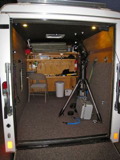

I think I bought the tongue box from Costco online. It holds my 130 amp hour battery
and oddball stuff such as wood pads for my leveling stands. I also keep an extension
cord in there for the rare time I am camping with AC.
Imaging with a camera and telescope can take hours on some of the targets.
Once everything is working well I let it run automatically and use another telescope
to look at other stuff with my own eyes. It gets cold off course and thats why I need
someplace to come out of the cold on a winter night when staying out until 5 or 6AM.
I often will take an hour or two nap so I wanted a safe furnace in case I dosed off.
The trailer lets me take my family with me sometimes to go camping with the astronomy gear.
Without it my scopes, mounts and camping gear take up the rest of the Highlander.

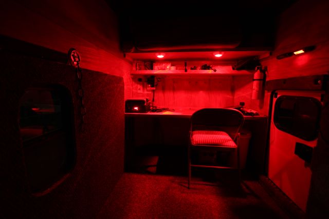

Postby mikeschn » Sun Nov 15, 2009 5:32 pm
Got an interior photo with just the red lights on? ;)

Postby astrotrailer » Mon Nov 16, 2009 12:33 am
Here's a couple of wide inside shots of the trailer showing the difference between white and red led lighting.
I use the red to preserve my night vision. The camera makes the red look brighter than it really is.
Notice the crash foam above the low door on the right. It has saved my head quite a few times.
The two lights above the desk have 3 position switches (red/off/white). I have 3 more white lights in the ceiling and two
red only and two white only wall washers. I started out with the 4 wall washers and one ceiling light and decided I needed
more. I can turn on all the white led lights at once and only draw 0.4 amps
