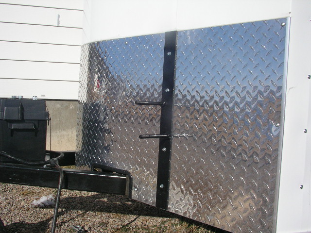

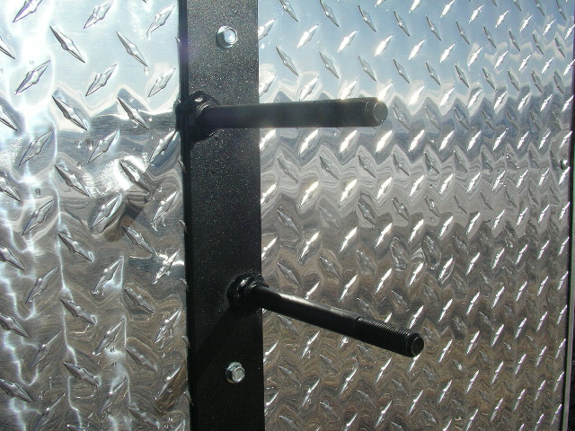

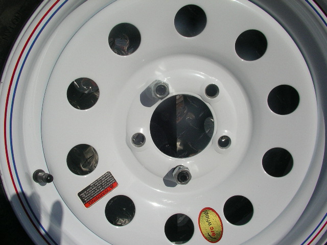

The molding on the wall/ceiling intersection is actually bright silver aluminum! The photo doesn't reflect it properly in the light. I have to confess that I ordered the trailer from the factory this way, with Luan ceiling and 3/8 plywood walls. I'm starting a thread soon that will tell how I ended up with what I have, and why.
That little nifty spare tire mount I got from the dealer. They had some there that they used on most of their trailers, and I'm not sure if they're buying them elsewhere, making them in house, or perhaps even they're coming from Haulmark. They didn't charge me for it, so I didn't ask! Its mounted with 4 screws into the 16" center support on the nose. Tire is held on to two welded-on lugs, just like a wheel, with lug nuts. At only moderate-tight, its tight as a drum. Gives you spare lug nuts too!
I chose that location because I figured the draft of the tow pickup would minimize any drag in that location anyway. Mounting on the rear door seemed like it would be in the way, on the inside anywhere would not be an option, and on the side would result in too much air drag. A tongue mount would not leave room for the battery there, and possibly a larger cargo box of some kind in the future.
Its in a convenient location to keep the air pressure checked, not cause any drag, and be easily accessible with the same lug wrench as for the wheels. Instead of lug nuts, somebody out there makes two little "arms" that can also screw onto the lugs, and then be secured on thier ends with a lock for security. I don't go into many places where tire/wheel security is an issue, but I know spares are stolen all the time. That would be the safe way do to it. I have some on my boat trailer's spare.
Here's some Pics!
Precisely my thought too. And thanks for the good photos of that bracket. I'm going to make one just like it now.
