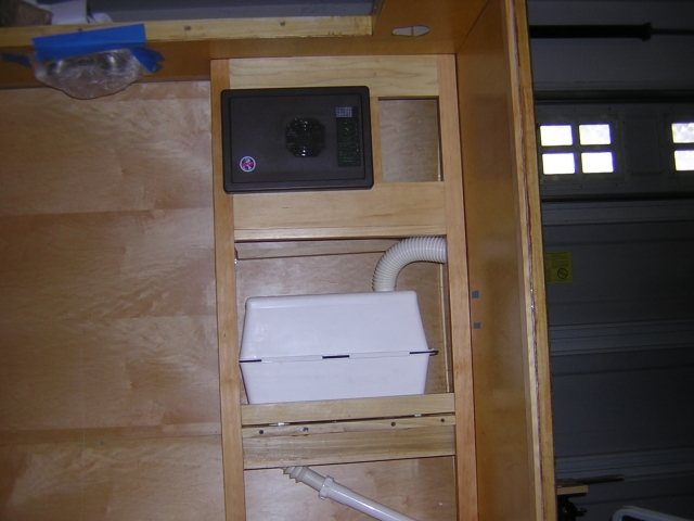

Postby S. Heisley » Mon Dec 28, 2009 10:12 pm
Ronaldito:
Here is an example of a battery box that might work for you:
The above box can be purchased at most any RV supply store for about $37. It is made by MTS Products. It has a hole in the top, for battery's chemical venting, and a hole in the bottom, for fresh air intake. The flexible hose and fittings for the top come with the box as you want something that fits well over the outlet. For the bottom, you can just use PVC piping to fit your needs. (In the above picture, the vent holes have not been cut yet as this was the first fitting of it in the cabinet.)
The box is made up of two equal pieces with sealing foam tape added where they are joined together. There is a small hole on each end that allows the wires to enter. While not evident in the picture, I am using a simple screw with a wing nut on each end to keep the two parts together.
...Hope this helps!
