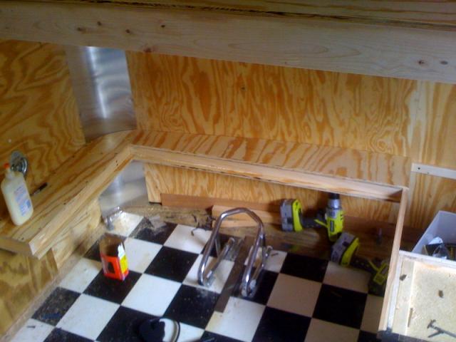

Postby vtx1029 » Wed May 19, 2010 1:38 am
Got the upper bunk done. It holds me so good enough :lol:
On to the lower bunk. Part of it will be hinged for the motorcycle chock.

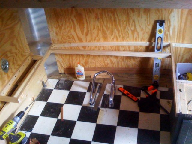

Postby vtx1029 » Thu May 20, 2010 10:21 pm
Got some of the lower frame work boxed in. Wow did that stiffen things up!

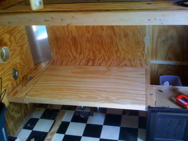

Postby vtx1029 » Sat May 22, 2010 9:48 pm
Got my flip down door made. What you guys think look strong enough for a bed? I glued all the joints and plywood on the door but I used a trim nailer to attach the plywood to the frame. I may go back and screw it just for a little added safety. I will also add some vertical supports...

Postby mdvaden » Fri May 28, 2010 9:23 pm
A question ...
On the undeside of the flip down door or lid, what's the function of the small short pieces?
I can understand how the long pieces ad support. But my mind is not registering how the small pieces would do the same. Or what their function is.
But I'm sure you have a reason, and was curious.
