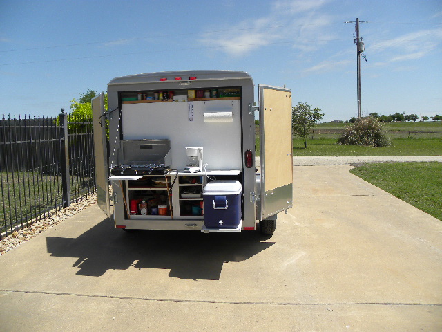

I converted a Wells Cargo 5x8 V-nose over the winter. I actually had so much fun doing it that I would like to build another one. It is listed on the for sale forum, but we have made three trips in it already and are really enjoying the freedom of having a simple lightweight camper. I built it to use, so that is what we plan to do until someone else wants it.
Now for my question. I am thinking about adding an air conditioner. I could go thru the back door with a window unit or maybe under the front bench kind of like a Casita, but the optimum solution is a roof unit. The ones I have found weigh about a hundred pounds. Does anyone know if the roof of this trailer will support that without any modification? I could call the factory but there seems to be enough knowledge on this sight to get the real info. I had the factory install the ceiling insulation and headliner, I would hate to have to remove it all to add support. Hiram

Postby travelman » Thu May 06, 2010 4:22 pm
Thank you for the kind comments. I'm thinking that a 5x10 V-nose will give me the same living area but let me build a bigger galley, without that much increased drag. My wife and I didn't think we would really do a lot of cooking, but we are finding that not to be the case. And on a small trailer I wouldn't want to cook much inside. Too hot and messy! Has anyone put a roof unit on a Wells Cargo?
