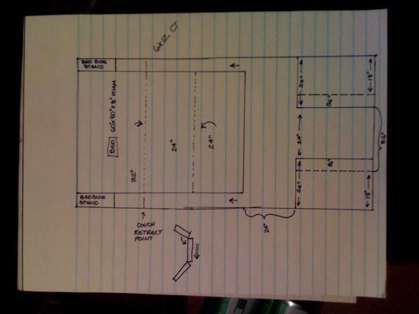

This is for a 6x12 trailer with basic amenities - I'm actually attempting to do a lot of off grid camping and keep things minimal, portable, and using solar for minimal lx if the budget allows.
The basic idea is built around a 60x80 bed (queen size) with 8 inch memory foam that folds into a couch at the back of the trailer. Some narrow side tables would provide space for a clock or phone, or a drink. The bed pieces would fold envelope style like the scribble on the side, leaving a footprint of about 32 inches front to back and nearly 6 feet of open space for a portable table and chairs in bad weather.
With the bed out, I have 2 feet between the galley and the foot of the bed for changing and moving around. My galley design has shelving running along the sides of the trailer with cubbies above and below for storage. I'm trying to decide between a shelf depth of 24" each or 18" each. It gains me a foot of maneuverability getting in and out of the trailer.
I'd probably put a couple of small windows along the bed sides, a fan in the roof, and a drop down screen across the barn doors to keep bugs out. Maybe some light storage cabinets above the bed for blankets, etc.
Thoughts?

What's the height?
What's the exterior shape (profile)?

Postby Kixwy2 » Tue May 18, 2010 1:14 am
I'm looking at a Haulmark style trailer, so not a v-nose, and I believe they run just under 6' in height. I'm a whopping 5'4", so that isn't an issue for me.
However, I don't think a side door will work for me with this design, so I'm going to exclusively use the barn doors for entry/exit.
I know that interior dimensions can vary from trailer to trailer, which is why there's about 6 inches of "give" along the sides of the bed, and plenty of space for the galley and open space.

Postby starleen2 » Tue May 18, 2010 11:24 am
I’ve seen many designs that incorporate a folding bed or one that converts to dinette. Unless you need the space for something rather large, I don’t really see a necessity for a fold up bed. It’s a PITA to keep on folding and making up the bed for a potential event that can easily be taken care of with an awning. In rough weather – we can sit on the edge of the bed with a small folding table to play games on.

Postby Kixwy2 » Tue May 18, 2010 10:55 pm
Thanks Prem, that's a good point about the barn doors I didn't think about. I may make a second set of weather-proof doors based on your comments alone. The other option I thought about is to add a side door towards the back of the trailer, between the bed and the galley. Of course, that may make it right over the wheel well.
Right now I really like the "flow" of the floor plan, and I am having trouble visualizing the bed anywhere else. Also, clearance on a side door may be a problem - seems like best case scenario gives me a foot to get in and out even with the bed pushed up against the driver side.
Starleen, realistically I may never move the bed into a sofa position, but it would be nice to have the option if something comes up or I need to move something big. I was also considering having one of my galley shelves flip up, this giving me more room if needed.
I'm trying for maximum flexibility, if that makes any sense. :)

Postby Ageless » Tue May 18, 2010 11:52 pm
With this and many others; I have to question size of the bed. Seems everyone has to have queen or king and I just have to ask . . why?
Yea, I'm thin and can fit in a Navy 27"bunk, but do you really need to waste space with a queen? It's not like you are at home and have plenty of floorspace; this is camping; space is at a premium.

Postby vtx1029 » Wed May 19, 2010 12:33 am
I agree with the entry door I would get one. I think we would be lost with out ours. I'm also more of a drop down door fan then the cargo door styles much more useful imo.
Why not build some bunks up front, its much better use of space or do a drop down style bed.... I'm building some bunks in our trailer right now and they should be super comfy.

Postby BC Dave » Wed May 19, 2010 12:37 am
Kixwy2 wrote:....that's a good point about the barn doors I didn't think about.
... glad to see you took my advice ... fixed the lamps ... "now go build a tear" ... :)

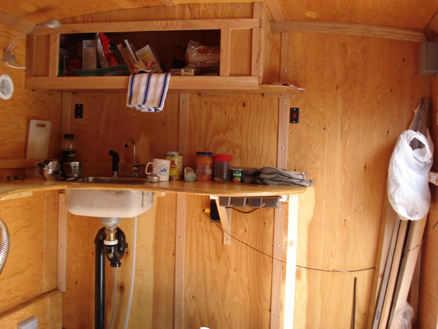

ok ... so your going for the larger 6X12, intresting; I love the space in the CT and have used it lots of late in the cold winter and am happy with the design; the exterior shape is utilitarian but oh well it serves its propose; look up my CT design in "build journals;" a work in progress and pics in album; beds are dismantled in pics, note the movable 21" ht boxes;
Things I have noticed ... I use the side door as opposed to the barn doors; pay attention to the comments above and design around the doors; i did manage to use 2 sliding barrel "snitche" locks on the barn doors to lock from the inside and one on the front door.; Ive seen others install RV style locks, that I'll install in the future.
I have found in colder wet weather I have spent more time inside that i ever imagined; so the couch idea is a good idea; fold up the bed so you have more room to manouver and a place to sit down will be much appreciated ... also I have used my coleman stove inside with the door adjar and the vent fans going ( not recommended for 2 reasons, #1 - burnt gas = CO2 - can kill; 2- lots of moisture is generated from cooking and burning white gas; but it was too cold to move everthing outside...).
Your using up lots of space for the cupboards in the front; you could go to 18" and make them movable boxes to sit on. Consider upper cupboards in the front, then they'll be out of the way and handy and along the upper sides; on the sides make them not so tall / deep, say 10" max, and below bed storage movable box ideas ... now your getting flexable.
Cheers BC Dave

Postby Kixwy2 » Wed May 19, 2010 1:12 am
Hey BC Dave,
I watched your build, especially the nifty heater you added. :thumbsup: I was seriously considering a 6x10 but when I taped it out on the floor I was a little surprised at how much space was taken up by bed length. Even if I cut the bed to a full size, it only drops 5 inches, from 80 to 75.
Definitely planning on cabinets above the shelving and above the head of the bed/sofa.
Here's the thing: I go camping in some very extreme conditions - like out in the desert, for almost two weeks at a time. Not only can it be extremely hot, but winds kick up and blow everything all to hell, even the best secured shade structures. Last August we had a tethered 10x20 shade structure made with 3/4 inch galvanized pipe, couplers, and tarps blow up and crumple in on itself. Last May up in Benton, CA a bunch of us campers got a surprise three hour flash flood/hailstorm. Anyone in a tent was flooded, and people who were camping in the back of trucks were suddenly in town drying out their belongings at the fluff and fold.
So being able to get out of all that is a huge deal. I do backpacking trips and don't mind the Thermarests and mummy bags, but if I'm in a spot for a period of time, working a gig or otherwise, I want to be fairly comfortable. I really like the idea of a galley accessible at the back by the barn doors, but I'm having issues with the bed and a possible side door...

Postby DougH » Wed May 19, 2010 12:26 pm
Who says the galley has to be the same widh on both sides? Make one 24" for the "working" side and the other 18" or even 12" wide and use mainly for storage.
