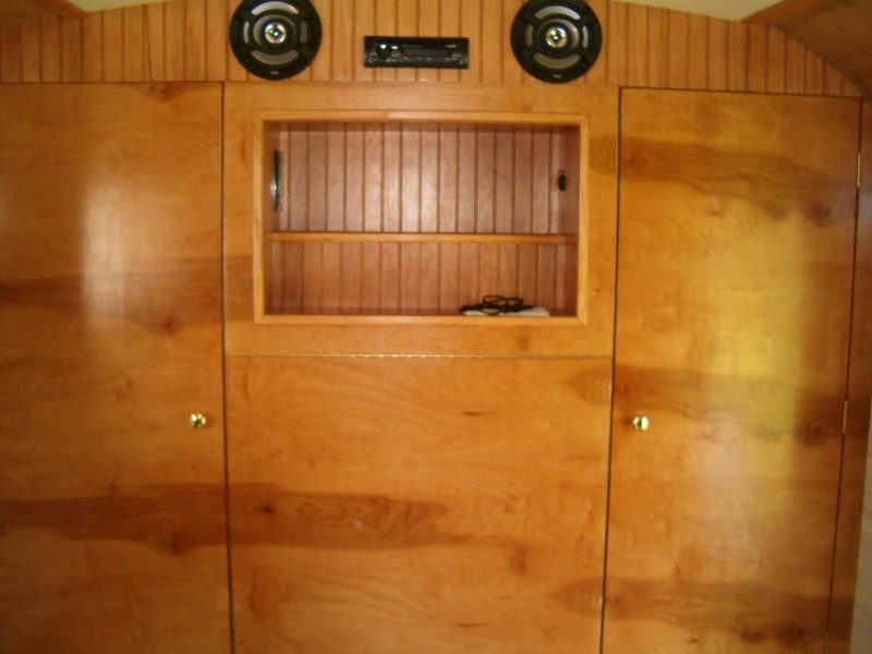

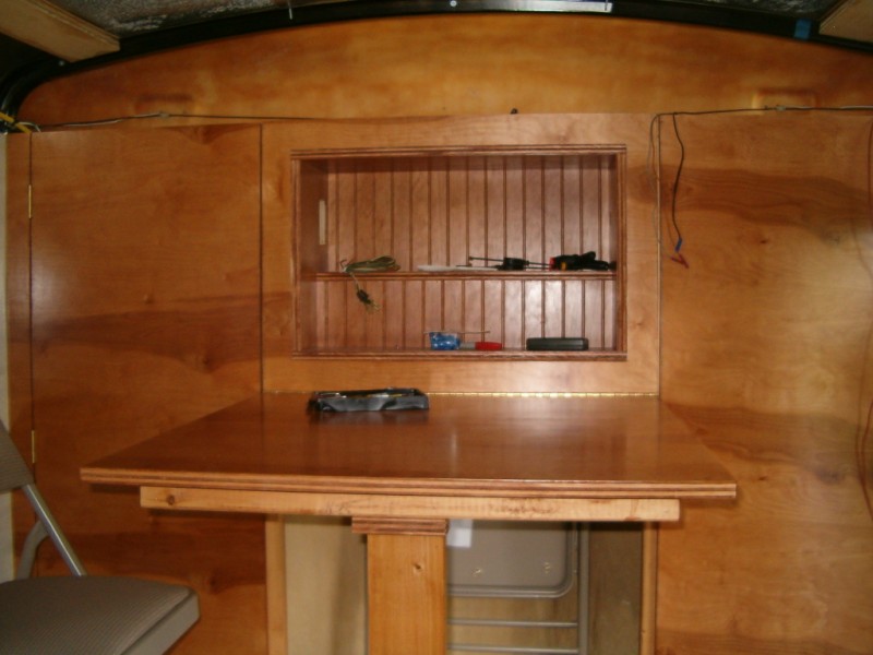

Here's a couple of my setup the table is about 28 in. sguare. It's big enough to eat off of and to play cards when the weathers bad. The chairs store behind it.
I hope these help you out.
Kevin

I'm getting ready to build a table too. Glad this thread came up. Building it so the chairs store behind it is a GREAT idea. Hadn't thought of that...

Sweet idea hiding the chairs behind the table Kevin57. :thumbsup:

Yep, the folding Table above w/Chair storage is very nicely executed.

Postby kevin57 » Tue Jun 15, 2010 8:51 am
Thanks for the comments everybody
I determined my table height by measuring our kitchen table. Then did a mock up using the chairs to make sure everything was ok since the table is at the front of the trailer. I only had 69 inches to work with and I wanted to make sure we both could set at it, and not have much trouble getting in and out of the chairs.
