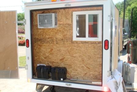

Postby michiganflipper » Mon Jun 21, 2010 7:07 am
here is where I monted mine but I had vented it out the back doo and then out the roof

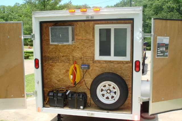

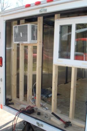

Postby kstephenson » Mon Jun 21, 2010 10:47 am
I built a wall about a ft inside of the rear doors. I then mounted my 5000 btu ac unit. It works great.
[img]http://www.tnttt.com/gallery/image.php?image_id=64316
[/img]http://www.tnttt.com/gallery/image.php?image_id=64317
In the Georgia summer I am able to keep the interior at 67 degrees. Insulated my walls and ceiling with 3/4 " foam insulation. My trailer is a PACE 6 x 12
Kevin

Postby kstephenson » Tue Jun 22, 2010 1:36 pm
The finished product
Kevin
