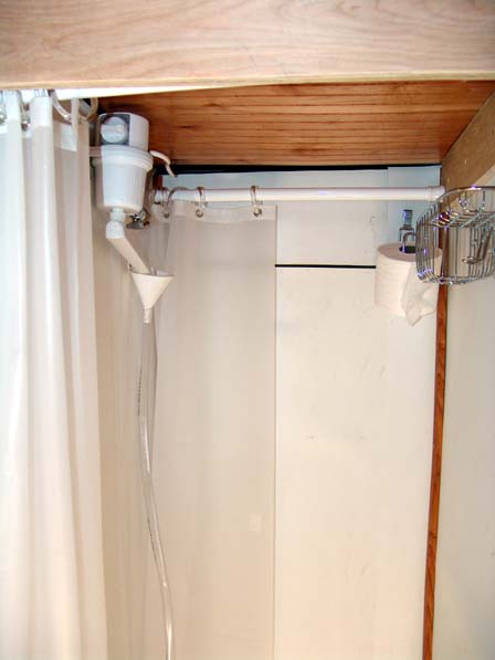

Postby jwhite » Thu Jul 08, 2010 8:21 pm
http://cgi.ebay.com/NEW-ELECTRIC-SINK-INSTANT-TANKLESS-HOT-WATER-HEATER-2KW-/310223916762?cmd=ViewItem&pt=LH_DefaultDomain_0&hash=item483ac94eda
This is what I bought and it works fine but you have to buy a water flow tap to control how much water goes into the heater,the slower it goes in the hotter it gets.
also mine came with a plug for use in Europe I had to cut that off and put on a universal plug for it to work.
also this is made to use over a sink and you have to use the faucet made for the heater,I tried useing a hand held shower and it would not get hot but warm.?
but it works fine just the way it comes to you.
