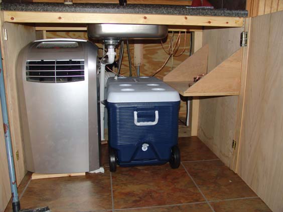

I was thinking that the framing for the vent should support the AC on the roof= it looks pretty sturdy to me?
I was also thinking that I would use the portable AC in a work room but from what I am seeing that the AC is haveing a hard time cooling the 7x16 trailer.
I have noticed that the exaust hose gets hot so I think I will wrap it with some insulation and see if that helps,the vnose area of my trailer gets hot so it may be leaking hot air into the same area I am trying to cool.
I am going to do more testing but I think I will have to get a Coleman Cub Roof AC some time next year.

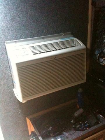

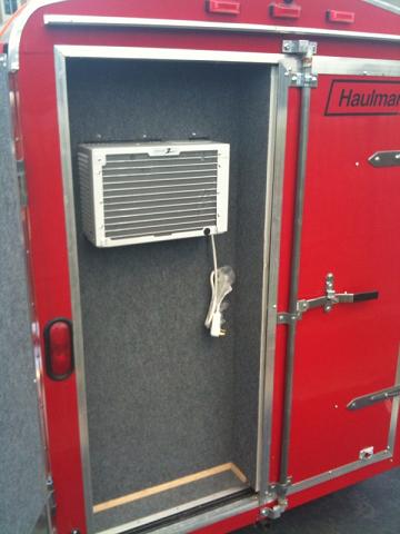

I just had a chance to use my new A/C this last weekend and was very pleased. This is a 5,000 btu Zenith window unit from HD and it made my 5x8 Haulmark cargo conversion quite frosty even in 100 deg. Georgia heat and humidity. It runs easily off my Yamaha EF2000is generator inverter although I ran into an issue trying to run the A/C at a very low setting over night using economy mode on the generator. The generator would be idled down due to the low power draw but then the A/C compressor would kick on and the gen would choke from the sudden load before it could increase revs. I have since read that A/C use is not compatible with economy mode.
I had originally planned to use a portable A/C in the trailer and actually ordered an 8,000 btu unit from walmart.com. Due to the size requirements of the unit, I decided against it, though. Used it in our sunroom for a while and then sold it on Craigslist.
The trailer has barn doors so I went with the L-shaped false wall on the left side. I can open that side to run the A/C and close and lock the right hand side. I use the trailer to go to bicycle events and the right-hand door is plenty big enough to get my bike and other stuff in and out.
