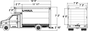

A friend of mine has several used Uhaul trailer boxes at his stables , used for storage ... He says he can get more .... CHEAP (250.00)
Makes me wonder if these can be mounted to a trailer for a cheapo camper conversion ???
The box looks something like this ... Image

Did a rough on site measure .... these seem to be about the size of the 14' box...
Bigger than I expected ... :o They looked smaller from the street ... :oops:
PLENTY of room inside ...

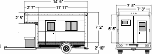

Postby GPW » Sat Aug 07, 2010 8:53 am
Just more thinking :thinking: Image

These boxes were really a lot bigger than I first envisioned them from afar ... When I got up close , realized how BIG they really are ... :o
Guess I need a bigger trailer , all I have now is a boat trailer ... 54" wide frame .... that's not gonna cut it ... Maybe I can find a bigger tandem boat trailer ... Still lots of empty trailers left from Katrina... some to be had for a pittance ...
