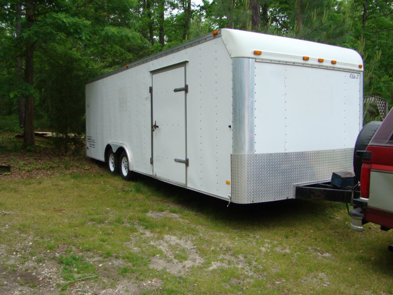

Ive been working on my car trailer trying to make chicken soup out of chicken......well you get the idea. It's been slow because I haven't been able to work on it as much as I would like because of the hot weather and I've been busy doing honey do's and other things. Anyway I thought I would post up some of my progress.
I'm not sure what the proper way is to do pics but I created a photo album here:
http://tnttt.com/album_ ... r_id=10895
I hope it works if not I'll try again.

Postby mx842 » Tue Aug 17, 2010 9:45 am
Shucks! It's backwards. You can go to the bottom of page and change the order of the pics and it may make more sense. Sorry, me and computers never did go together too well.

Postby d30gaijin » Tue Aug 17, 2010 8:00 pm
Good grief that thing is huge! :thumbsup:
Thanks for sharing your build thread, it gives me ideas, which I can really use at this point in my 6x10 conversion build.
By the way, nice M4 build and ammo supply. I keep a couple of those on hand along with ammo to suit.

Postby mx842 » Wed Aug 18, 2010 10:36 am
d30gaijin wrote:Good grief that thing is huge! :thumbsup:
Don
Well if I can ever help out just yell. Yes it does look big compared to these tiny trailers but they fill up fast once you pack in everything you need to head off to the track.
Once this is done I will have a toy hauler for the track and if I just go camping I'll have a rolling two bed room apartment. :lol:
I learned a lot doing this and I got a lot of help right here. The main thing is don't cut corners on electrical and use screws rather than nails, glue is good once you know for sure something is how you want it. Insulation is a must if you want to be comfortable and the roll insulation don't work worth a darn in the walls it will settle right down and out the bottom before the 1st trip is done.

Postby mx842 » Wed Aug 18, 2010 7:45 pm
AWK wrote::D My first post here! Thanks for sharing as I am treading down the same path as you. Maybe not to the level of a camper (water and all) but cabinates, electrical, lighting and TUNES.
Is this a 28 Ft trailer?
I am using the same converter has you have. I got mine for 65 dollars at a rummage sale!
AWK
Well welcome aboard. Not that it means much coming from me but someone with some clout will be along directly to give you a real welcome. :)
No mine is a 24' HaulMark. It was used when I got it but used very little. It made one trip to California from the Chicago area and back to Va and it sit for a year or two before I talked the old owner out of it. It was use for an office trailer....well, a card playing room would be more like it so it never saw much abuse.
All I can tell you is to read up on the electrical sections and don't play around with trying to cut corners in that department because short circuits and flaming wires can be deadly. AND costly, I burned up my first converter by hooking it up to 220 by mistake and that wont pretty. Not only did it skert do heck out of me it taught me a lesson.
If I can ever get time to finish my two water tanks I can finish this in short order. Those converters are good as long as you don't over load them like I did. The company fixed the old burned up one so I'm back in action in that department again.
Are you going to insulate yours. I know it really makes a difference with cooling and heating but mainly it cuts down on a lot of the noise and makes the walls feel more solid. The 1" pink panther board I got at HD was around $9.50 a board and I think I used 11 or 12 boards in mine.
If you need any help just yell. Sometimes I come here every day but I do miss a day or two every now and then. I'll be glad to help any way I can.
