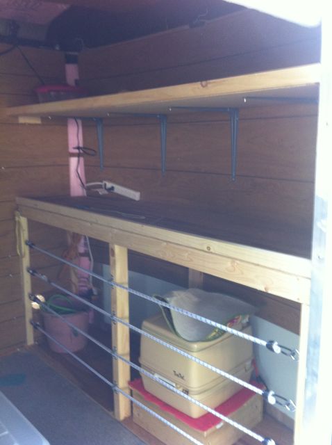

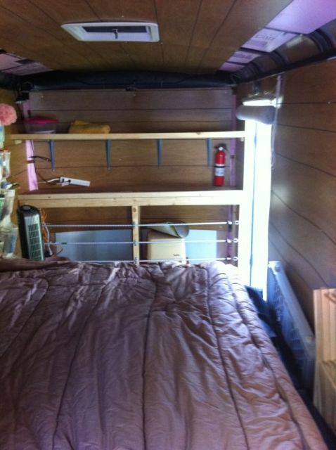

I have been lurking here since last fall and decided to take the plunge. I started to convert my 6x12 Haulmark a few months ago. working on it when I get the chance. We spend almost all our time outside when camping so our main priority is getting a good nights sleep. Thus the queen size bed that takes up most of the room inside. The frame is lightweight (overstock.com) with plenty of height for storage underneath. The frame and bed can be placed on the side for more room if needed.
We also wanted air conditioning but did not want the expense of a roof unit so I built a small 2' wall and installed a 5000btu window unit. It does a real good job of keeping the place cool. I have insulated most of the CT with the 1" foam. Under the air I screwed in a funnel and connected a hose for all the condensate to drain on the ground.
In the front area where the CT bows out I built 2 counter tops, one over the other. And below I have a nice large area for bigger things that I can control with the bungie cords.
