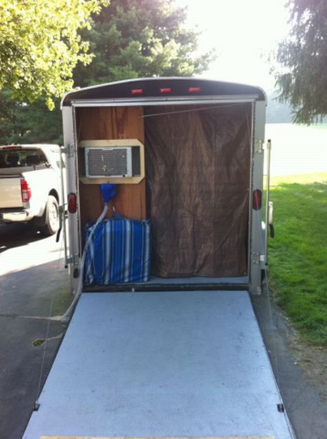

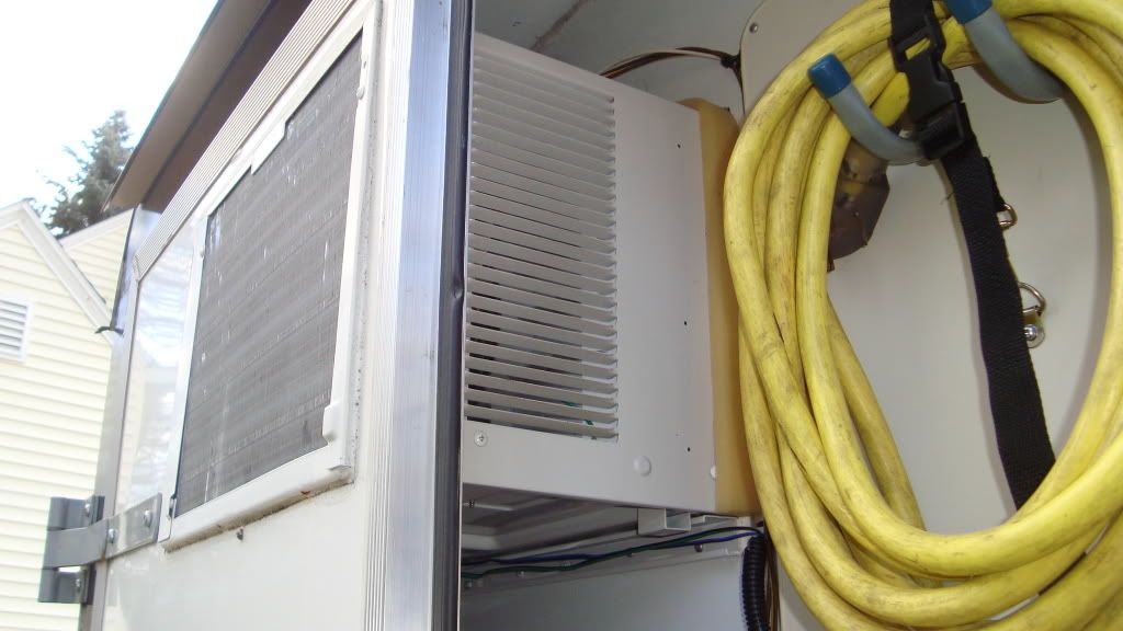

Here is how I did mine. As long as you have good air circulation you should be good mounting it most anywhere. I mounted a funnel underneath it with a hose clamped on the bottom to direct the water away from the inside of the trailer. The top of the wall is tied in to both sides. I just used 1" X 3" for the header.

Postby LShrew » Mon Sep 13, 2010 6:05 pm
Yes, the ac is a typical window unit. I sat the ac on the floor inside the door about 2 inches from hitting the door. I marked on the floor where the window sill would be and that is where I built the wall. The wall is made of 1 x 3" and the back of the wall is about 6" from the door.

As long as you have all of the intake louvers on the sides of the unit uncovered you should be fine and yes it does have to vent/have hatch open.
Postby LShrew » Mon Sep 13, 2010 10:50 pm
Shodow Catcher is right. The side louvers need to be able to draw in fresh air. The rear sends out the hot air and needs to be vented. I know that 1st hand. During some of the inside build it was real hot outside and I thought that I would cool the CT off so it would be nice to work in. I turned on the AC and went into the house until I thought that is was cool enough. When I went back out I opened the side door to a blast of hot air. I never opened up the rear ramp and I just heated up the CT more than it already was. :oops: Live and learn. :thumbsup:

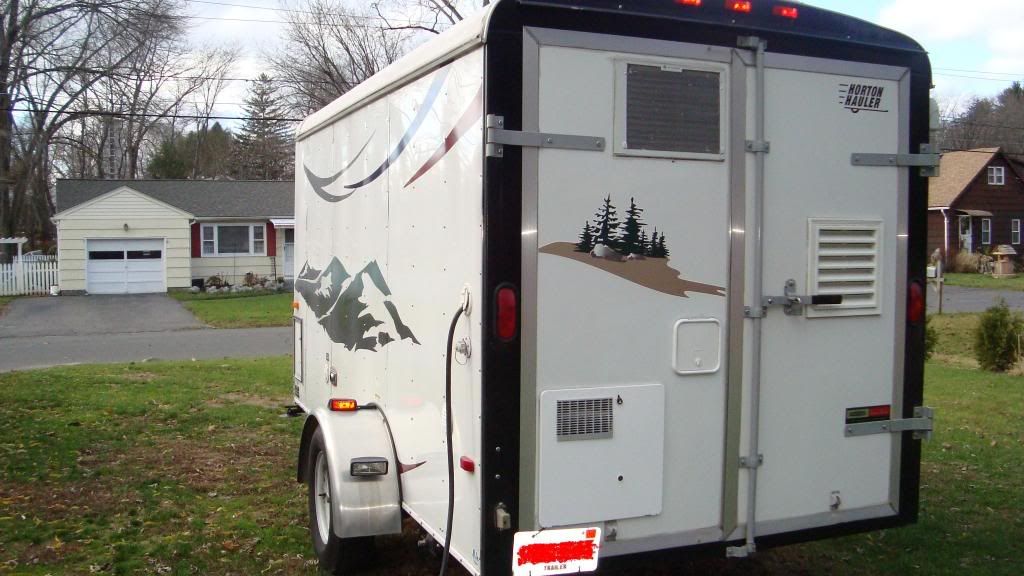

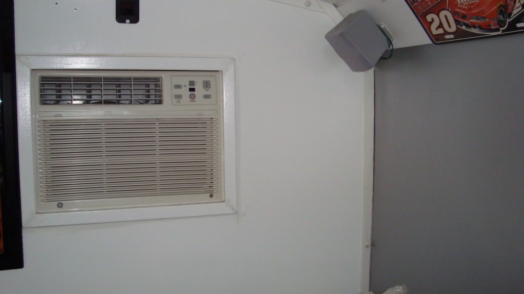

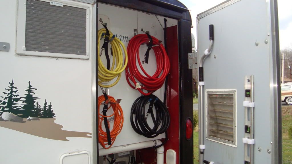

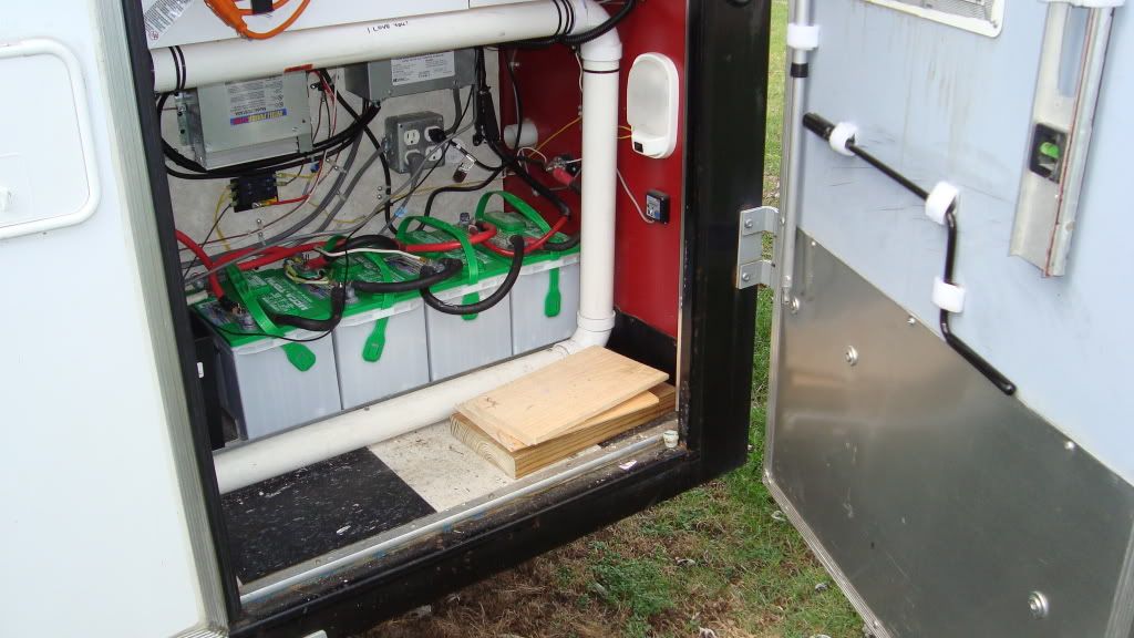

I did mine a little differently. My left hand barn door is sealed shut and the A/C, outside shower and water heater are mounted through it. I installed a bulkhead wall to separate the rear storage from the interior of the camper. The inside portion of the air conditioner sticks through the wall.
The right hand door opens to gain access to the electronics / storage area. I vent the compartment with an inexpensive gable vent from Home Depot. This vent provides ventilation for the electronics and allows ambient air to enter for the air conditioner condenser fan vents on the sides of the air conditioner. The air conditioner works great and the water from the air conditioner drains outside so no drain pain setup is necessary.

edcasey, that is a very nice conversion except for the Tony Stewart photo. Just kiddin' about the photo. It looks well thought out. I have a ramp which is a little bit different than your barn doors. We use the ramp as an enclosed porch when camping. That is where we spend most of the time when at the CT. I could not think about cutting a hole in the ramp so the little wall was another option.

LShrew wrote:edcasey, that is a very nice conversion except for the Tony Stewart photo. Just kiddin' about the photo. It looks well thought out. I have a ramp which is a little bit different than your barn doors. We use the ramp as an enclosed porch when camping. That is where we spend most of the time when at the CT. I could not think about cutting a hole in the ramp so the little wall was another option.
Thank you. I haven't been on this site for a while and it's great to see all the new builds. Yours looks great and has some excellent ideas. I assumed the OP has barn doors because they asked if the doors had to be kept open. Either way, it can certainly be done. The Tony Stewart photo was a collector's clock that I bought a while back. My two year old decided to play with the hands so now it really is just a picture.
