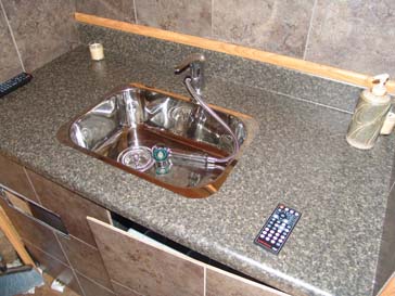

lowes also has some great premade counter tops with some really nice colors and they have the 4x8 sheets that match,I think I would go that route if I were doing it over,but I found some nice carpet remnant and glued that on the walls and saved some money.
here is a photo of the counter top they are premade in 4ft sections,you can buy them longer than that and cut it down but 4ft was all I needed.
they also come in a - tan- black -this is grey.
