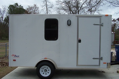

Postby james worley » Sun Feb 20, 2011 8:13 pm
Here are a few pics of my cargo trailerImage

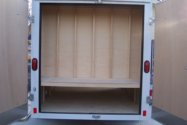

Postby james worley » Sun Feb 20, 2011 8:15 pm

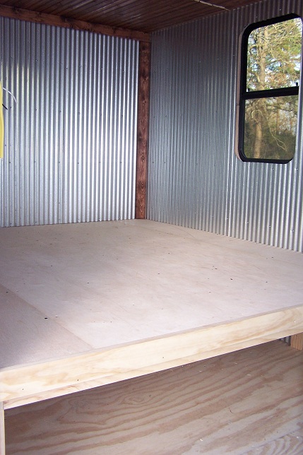

Postby james worley » Sun Feb 20, 2011 8:16 pm

Postby Loader » Mon Feb 21, 2011 8:05 am
Looking good James! Where you putting the indoor pool and hot tub in that build! :lol:

Postby bc toys » Mon Feb 21, 2011 10:42 am
Thats a great job you got going on there. does the bed fold up in to a couch or somethiing. Was thinking about changing my trailer and adding a galley.

Postby Dant » Mon Feb 21, 2011 11:21 am
james worley wrote:Image
Looks good. What exactly are those aluminum interior panels?

Postby GPW » Mon Feb 21, 2011 11:24 am
How do you eat when it rains ??? :o
Postby Dant » Mon Feb 21, 2011 11:27 am
bc toys wrote:Thats a great job you got going on there. does the bed fold up in to a couch or somethiing. Was thinking about changing my trailer and adding a galley.
Nice build yourself. What did you use for insulation? Is that Prodex or aluminized bubble wrap? Then you added styrofoam sheets?
I'm about to buy a 6 x 10' or 12' + 2' V-nose from Continental Cargo (Forest River). I want to insulate. Then not sure about what for interior panelling. Want to keep it as light as possible.

Postby james worley » Mon Feb 21, 2011 8:10 pm
Hello Earl. I knew i was forgeting something, i will have to add it on the next build :thinking:
Dant,layed 3/4" foamboard R-4 in between metel roof supports ,then built the ceiling joist 3/4''by 1 1/2''and layed two sheets of 3/4''foam board between the ceiling joist for a total of R-12.
The panels are 26 gauge galvinized metel, 1 1/4 centers 1/4'' wave.

Postby 4x4chvy » Tue Feb 22, 2011 4:05 pm
I like the galvanized. Looks SWEET!
