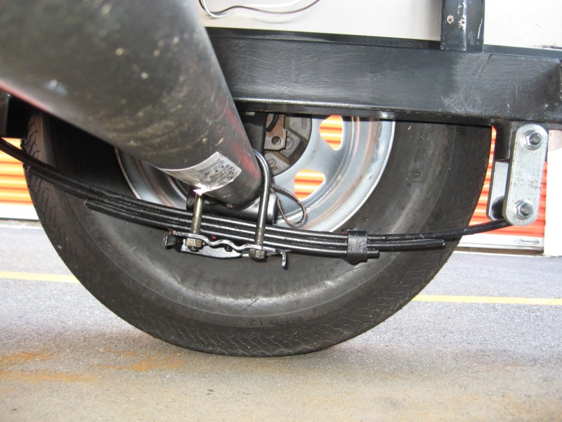

Hey, if you don't mind, where did you get the nice wet bolts?
Great picture....
Jeff
sjordanjeff
Posts: 25
Images: 19
Joined: Sun Oct 31, 2010 9:59 am
Location: South Jordan, Utah
Postby woytovich » Thu Mar 31, 2011 12:40 pm
Those are bolts for a Toyota Land Cruiser from CCOT:
http://coolfj40.stores.yahoo.net/shacklesaussie.html
I just grabbed that for a picture example... these are way to big for a small trailer.
