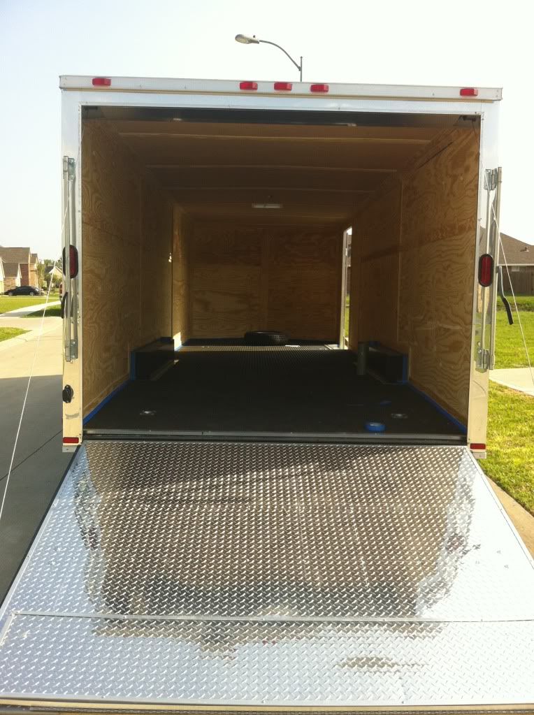

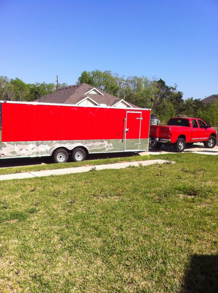

I've finally decided to quit being a lurker and join the club. I just recently ordered an enclosed car hauler, custom made and delivered all the way to Texas from Georgia. The plan is to build it into a toy hauler style camper. I originally had another trailer built last year that was a 6x12, then quickly realized that was too small for how I wanted to use it. So now onto the new trailer.
THE TRAILER

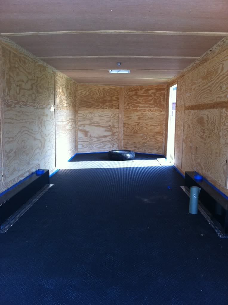

Its a 8.5x24 V-nose made by Hurricane Cargo. To save myself time and a lot of frustration I decided to have them insulate the walls and ceiling as well as install a rubber diamond plate floor. I insulated my 6x12 myself and it was not much fun. The only other big change I added to the new trailer was to have the 4" drop axles removed. This trailer will be off road in dirt lots and fields so I figured I would benefit from the extra ground clearance. The only con with my trailer is I messed up and ordered it with the 3500lb axles instead of the 5200lbs. It will still work fine for now but bigger axles will be needed in the future.
MY PLANS
So far I have primed the interior white. I'm not sure what color I will paint it but I'm leaning towards white or maybe a light tan color. I'm also open for any suggestions.
I chose not to go with a rooftop A/C and I'll be buying probably two 10,000-12,000btu portable a/c units to build into the front of the v-nose section. Texas is hot and I'd rather have double the a/c needed then sleep sweating. The exhaust ducts will be plumbed through the floor. I cringe at the thought of cutting into the metal exterior. Throw in maybe 3-5 cabinets, nothing expensive or fancy. Then add not one but two futons to position in an L shape for a poor mans sectional type setup. Maybe figure out how to rig up a hinged or non-permanent divider wall so I don't have the smell the atvs at night. And that is as far as I have gotten with my planning.
