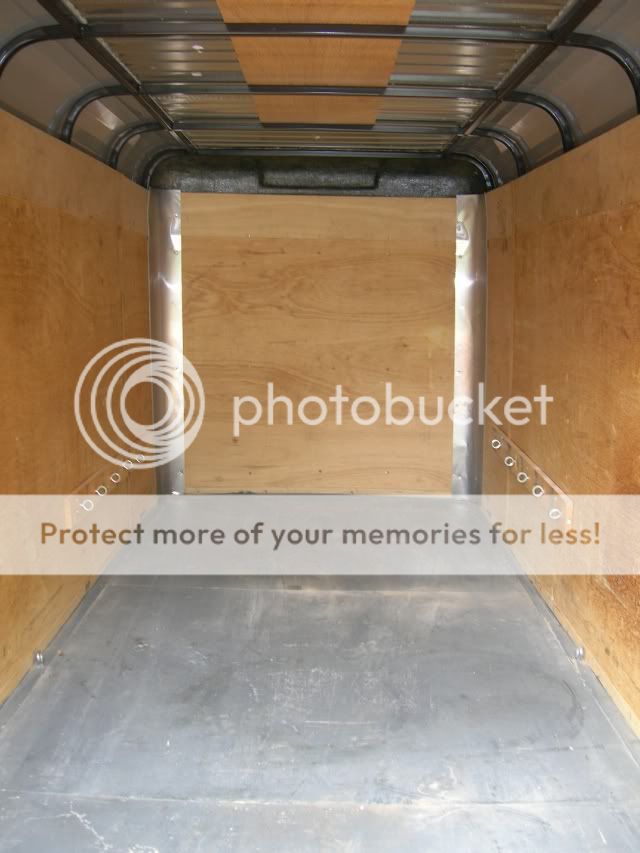

OK, bought a '04 5x10, pretty good shape, no side door, no top vent. Is a vent important? It's only 61" high. Have drawn out plans for inside build, everything I want will fit OK. Will only be inside for sleep or cooling off in the heat. Planning on building a false wall in back with door and hole for small window unit A/C. Cabinets/Closet in front, built in bed w/storage underneath, vanity w/sink and hand pump for water coming from 6 gal tank and another tank for grey water. Have a good friend who's an electrician who will wire everything for 110. Will only use at places where there is electric hookups or can use my 3500 watt generator.
here's the photos;
http://i829.photobucket.com/albums/zz21 ... ler003.jpg
http://i829.photobucket.com/albums/zz21 ... ler005.jpg
http://i829.photobucket.com/albums/zz21 ... ler009.jpg
http://i829.photobucket.com/albums/zz21 ... ler010.jpg
http://i829.photobucket.com/albums/zz21 ... ler013.jpg
Main question is: do I really need a roof vent? I won't have a battery or be using heat inside (won't use in the winter) just a/c.
First up is removing the Luan on walls and roof and insulating, replacing with 3/8" plywood to have something to screw cabinets ect to.

Postby GPW » Sun Apr 10, 2011 2:55 pm
Lone, Good looking CT !!! :thumbsup: You'll need some kind of vent , doesn't have to be on the roof ...
Postby lonerider » Sun Apr 10, 2011 3:44 pm
OK, but with A/C in back where is best place for one of those side vents? Opposite side in back or up front? I guess I need some kind of circulation right? The insulation and plywood is gonna' cost a fortune up front!! Should the foam board be glued to trailer or just wedged in between studs and covered w/plywood?

Postby pete42 » Sun Apr 10, 2011 7:40 pm
A roof vent would help to get rid of some heat and also if used in the winter a vent helps remove the moisture.
most just wedge the foam into the sides and top some use the spray foam in a can to fill the gaps.
a closed trailer one with out any windows would be like a trailer at night even in the daytime.
some 12 volt lights would be nice to have when making a stop on the way to the campground say for lunch or to get a bite to eat or a nap.
how are you going to get in with a false wall and no entrance door?
good luck on what ever you decide to do.
