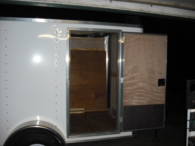

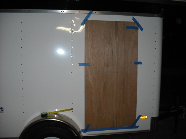

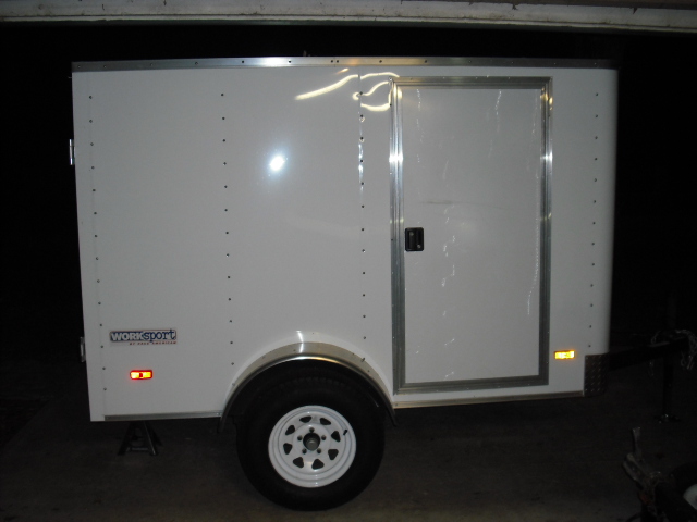

I got a bargain on a 5 X 8 a couple of weeks ago, and decided I needed a side door. I found a guy on Ebay who ordered a custom door for me and t was delivered by common carrier. It looked like it was dropped a few times, 3 out of 4 corners of the frame were bent, but I still accepted the delivery, I didn't want to file a claim and wait, for who knows how long... The frame was soft aluminum and straightened out OK. I measured, marked, measured again. The big concern was cutting a rectangle that matched the door.... I was thinking too hard. I put the tape measure and carpenter's square back in the tool box and made a template out of the 1/8" plywood from the door crate. 8)
A few minutes with a saws-all and the trailer had a gaping wound in it's side..... :shock: It turned out pretty good.
Steve

Absolutely no fear in that first cut, that aluminum was so soft it cut like buttah! The template and the fact that the frame flange was 1 1/4" wide gave me confidence that even I could chew a hole in the side of the trailer and it would still look OK.

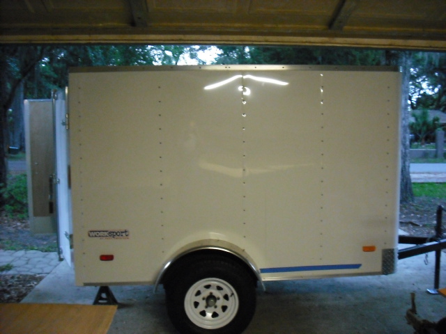

Steve, Super job !!! How tall is your CT ??? Fits in the garage eh ???

GPW wrote:Steve, Super job !!! How tall is your CT ??? Fits in the garage eh ???
It's about 5' inside and yup, fits in the garage, but no clearance for a roof vent

lonerider wrote:I've been thinking about a side door in my 5x10...how much did it cost??
The door was $198.00 delivered, custom size 28 X 56 with a flush mount passage lock with a deadbolt. Wouldn't suggest having one shipped, they tried to destroy it in route. Find a trailer builder close to you, that will make one.
