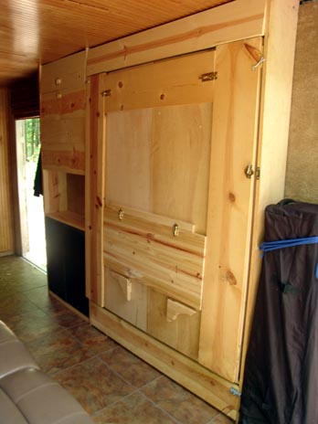

this is my bed folded up

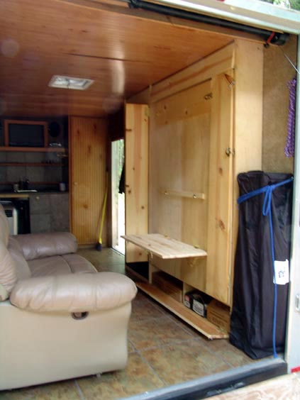

this shows the table down and the storage under the bed.also my ezup canopy in place.

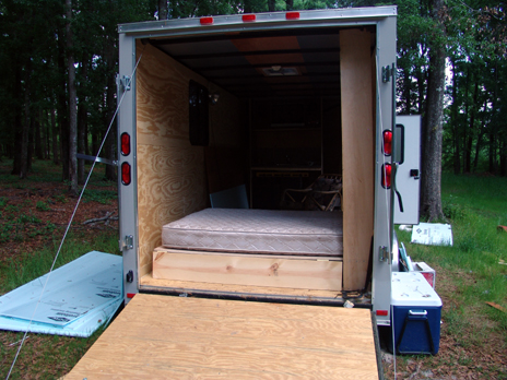

this is my bed down before I finished the inside.
I found out that this type AC needs to be out in the open,it stores away under the counter.

The bed
I had the mattress that I wasn't useing and it was in my way in the house.
it works great but it is heavy to put up and take down I have to drop the bed down then pull the mattress down,and the same putting it back up I have to grab the mattress and stuff it against the wall and then lift the wood bed frame back into place and there is not alot of room to get around letting it down or putting it back up if the ramp is up closed,easier to get around with the ramp down.
I have alot of room inside the trailer if I put the bed back up when I am not useing it,it's a little easier letting it down than putting it back up.
