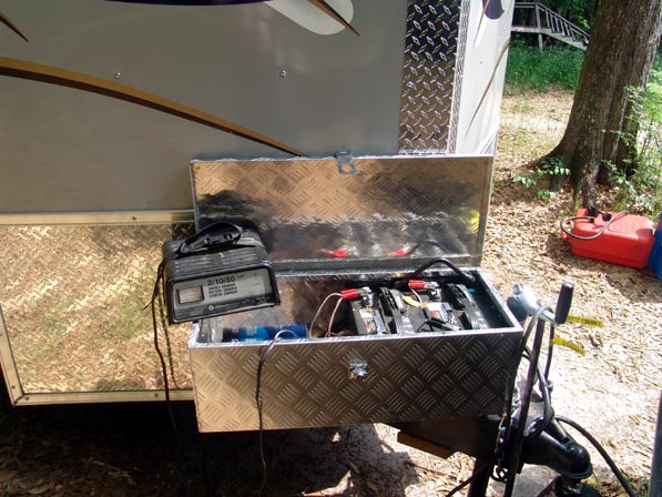

Postby jwhite » Mon Apr 18, 2011 7:18 pm
I had my batteries in the trailer and I had to haul them in and out to charge them it was such a pain I bought a lockable tool box off Ebay and I drilled holes in the bottom and ran the wires under the trailer then into the trailer.

Postby Nathan N » Tue Apr 19, 2011 5:31 am
I adapted a toolbox from Tractor Supply for a tongue mounted box that holds my battery.
I did not want to just loop the wires under the bottom edge of the rock guard/front wall as it would be too easy for something to flop up and pinch the wires. I opted to use strain relief connectors and drilled through the box and lower part of trailer's rock guard/front wall ( under the floor ). The wires then go up through the floor and are sealed with silicone.
