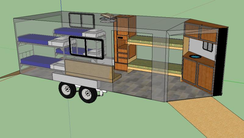

Postby vtx1029 » Tue May 24, 2011 1:29 pm
Here's the overall plan for the trailer but it may take a while to get to this point.
We got some of it torn down for insulation and windows, once that is complete I can start on the bunks and cabinets.

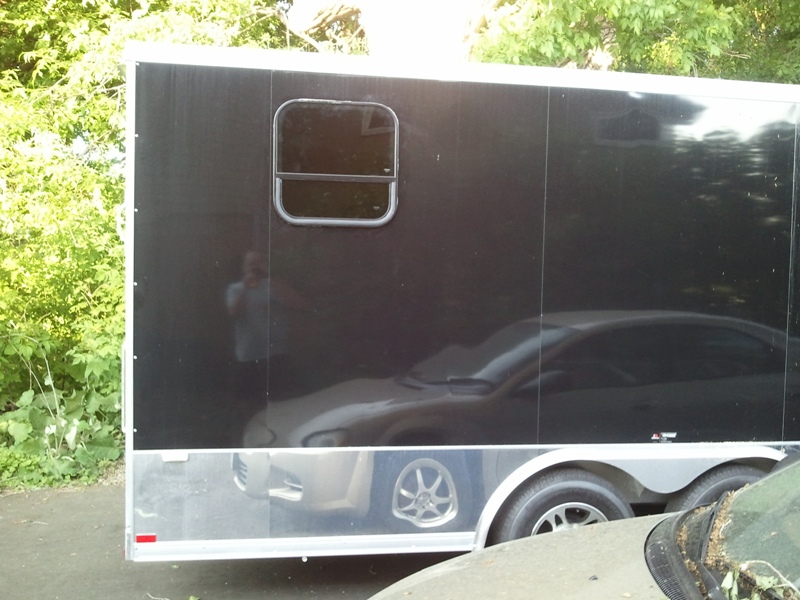

Postby vtx1029 » Mon May 30, 2011 11:04 pm
Got some work done :thumbsup: Insulation done on one side and walls back up. Got the window in the nose in just need to make a spacer trim ring for it to finish that off. Wired up 2 outlets and got the hose ran for the gravity fed sink.

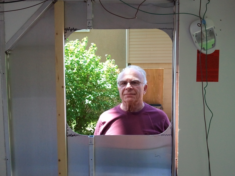

Postby vtx1029 » Mon Jun 06, 2011 6:17 am
Worked some on Saturday on the rig. Got the rear cross frame stabilizer jacks installed No picks of that. Got the second window installed and a couple of little things not worth taking pictures of.
No turning back now...
My cheap harbor freight body saw makes easy work of cutting out the window. Much smoother finish then any jig saw I've ever tried to use cutting metal :thumbsup:
