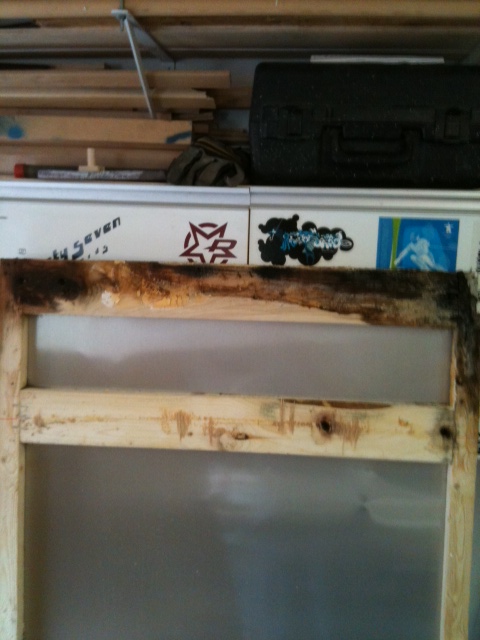

Hi All, I started my conversion of a 2008 Haulmark 6x12 approx. 3 weeks ago. Much to my dismay when attempting to insulate my doors I found that the bottom 12" of both the rear cargo doors and man door were completely rotted out and moldy. Being an experienced wood worker it wasn't a big deal to fix, just took extra time. Is this a common problem with these trailers?
I noticed that the original caulking was very poorly done and that none of the bolts or screws were sealed. Also, the bottom trim channel for the door did not have any drainage holes in it so any water that did enter the door cavity would be held in and lead to accelerated rot. Has anyone added "drain holes" to the bottom of their doors?
I suspect that without all door handware being caulked door rot will happen sooner or later, but probably sooner.
http://www.tnttt.com/gallery/image.php?image_id=78892
Rotted out
http://www.tnttt.com/gallery/image.php?image_id=78895
Rotted out
http://www.tnttt.com/gallery/image.php?image_id=78896
Repaired and insulated

Wow, thats nasty. Nice work on the repair. Good observation on the trim not being sealed properly and not having drain holes. You would think that kinda thing would a no brainer for a trailer manufacturer.

BUT If the seams were not kept caulked by the previous owners I can see where water could get into the wood
and if it didn't have a way to escape through the missing drain holes then you get rotten wood.
I would add some drain holes making sure they were dimmpled on the inside of the channel so water would drain
instead of drilling them from the outside which would leave them higher inside the channel than the rest of the channel .

Thanks for the compliments. I will be adding the drain holes today. I didn't think about drilling them from the inside out and the doors are already reassambled and caulked. Hmmm, I'll have to think about how much work I want to create for myself.

I removed the man door on my CT today to insulate and add the RV door latch. I found the same thing you did on yours. The bottom of the door is badly rotted! Now my CT is 10 years old, but I would have prefered for it not to be rotten. anyway, I get to build a new door frame tomorrow, so I can reinstall it. I am also considering modifying the design some. The original has a 1-1/8" thick frame with a 1/8" thick plywood inner skin, and an aluminum outter skin. I am considering reducing the thickness to 1" on the frame and installing a 1/4" plywood inner skin. This would maintain the original thickness, and I think make it a bit stronger. It will also prevent having a 1/8" void inside the door. The insulation I am using is 1" thick styrofoam board, so it should completely fill the voids. You can check out a couple of pictures of the damage in my album or on my thread.

Wow, you would almost think that we took pictures of the same door! It really is important to make sure the bottom of the door frame has those drain/weeping holes in it to prevent this. Nice repair!

Thanks for the compliment. I would not really call it a repair, since I completely rebuilt the frame. The only things I reused were the hinges and outer/inner aluminum skin. I do not think the issue that caused the rot was lack of drainage from leaking. Most liklely it was caused by condensation in the viod spaces inside the door. In the past, I built a wooden framed airplane (a single seater). One of the things that was stressed in many publications, was to seal the wood inside any completely enclosed structures to prevent rot from condensation. So when I rebuilt the man door, I sealed the inside with polyurethane spar varnish. That coupled with drain holes should help this door last a long time.
