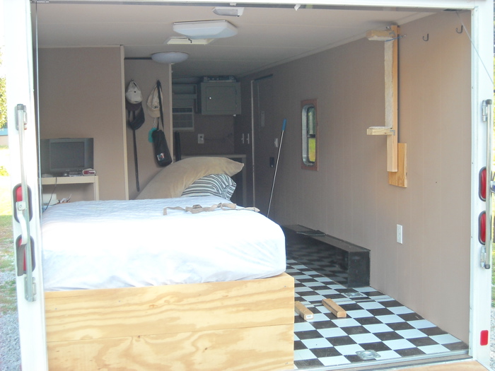

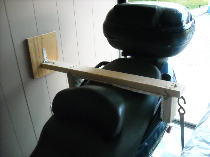

Here is a brace we made to hold our Burgman 650cc Scooter. Straps did not work since our bed prevented us from placing them perpendicular to the scooter body.

Postby vtx1029 » Wed Jun 22, 2011 11:21 am
You have straps on the front?
I just don't see that being strong enough I'd hate to see it break, loosen up, or cause damage to your scoot. I wouldn't feel comfortable using that setup but that's me.
My wife has a burgman 650 as well I just run a strap thru the back wheel and the strap goes out and back at a 45% angle. The front wheel is in a chock with 2 straps around the lower triple tree going out at a 45% angle.

Postby ho-do » Wed Jun 22, 2011 1:20 pm
Front wheel is in a chalk with strap keeping it firmly in place. There is one strap holding the brace down, very firmly. Two small wooden blocks keep the rear tire from moving side-to-side. The setup is very secure and a whole lot faster to setup and take down than a strap system. We have not had any problem with this system when we did one test of it from Savannah Georgia back to Alabama, about 8 hours on the road.
