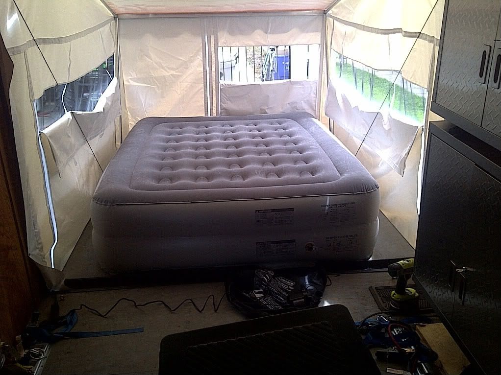

Postby woodenchef » Mon Jul 04, 2011 11:20 am
Hi, bought it from here:
http://www.interwestsports.com/
I also have the awning \ add-a-room for the side :D
My trailer is a 7x14 and I went with the 12' deluxe awning \ add-a-room for the side and the 6' standard for the rear because deluxe only starts at 7'.
Note:
In hindsight I should have went with the 7' which would have covered my rear ramp door better. The only issue is the bag that the awning rolls into would stick out a little if leaving it in rail while traveling, no big deal. if you have a 7' wide and looking at this I would get the seven deluxe instead of 6'
