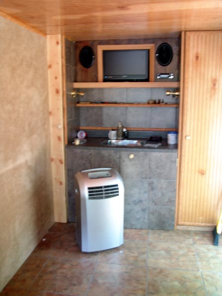

My questions are probably pretty basic but I've never done any insulating so I know nothing about it.
I looked at the foam board type insulation at Home Depot. All they had was 1/2". Is that enough? Seems awful thin to me.
Moisture barrier? Is that something separate from the insulation? What is it? What does it look like?
Do I just jam the insulation between the square tubing in the walls then cover back up with the boards that are now on the walls or is the insulation supposed to be fixed in place some way?
Is the insulation supposed to touch the outer skin of the trailer or is there supposed to be a gap between the skin and insulation?
Any pointers would be greatly appreciated.
Here's where I'm at now... Just starting. I do have a portable A/C inside so I can stand to work inside in this Louisiana summer time heat.

I like the portable air conditioner you have. I have been considering purchasing one for my CT to use until I get a roof top AC.

About the A/C.... I chose a portable for several reasons. Stealth (no one can tell it's a camper by the A/C on the roof), ease of installation (two 5" holes in the floor for the intake and exhaust hoses), and portability (I can take it out of the trailer and use it in another trailer or anywhere else I want to use it).
It's a dual hose unit. It doesn't draw air in through the cracks in the trailer like a single hose (exhaust only) unit does. The compressor side is what gets hot and needs the exhaust. This unit also has an intake to bring in cool(er) air from outside to cool the compressor. The evaporator side just re-circulates the air that is in the trailer cooling it down.
I gave the A/C a good test yesterday for about an hour. The trailer was HOT inside as it had been closed up for several days. I turned on the A/C and closed the doors. When I went back and checked the roof was actually cool to the touch where it had been too hot to touch an hour earlier. The temp inside the trailer was bearable, but not all that cool. I think once the trailer is insulated it will get about as cool as you'd want it to inside.
This is the A/C. It also heats. 14,000 BTU cooling, 13,000 BTU heat. http://www.whynter.com/productdetail/ai ... ioners/305
