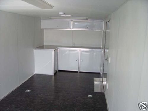

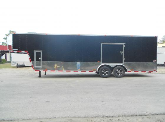

It is a very common feature on race car haulers from various vendors. They usually put a hatch door in the front on the street side, and build a faux cabinet inside to hold the generator:
I've also seen insulated cabinets used with vented doors and fans, but that might be too noisy for overnight use.
