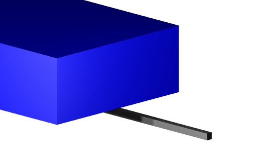

Postby angib » Sat Aug 06, 2011 5:06 am
I think the important effect with these fairings is not in making the front bullet-shaped but in providing a smooth path for the airflow from the front to the sides - if you look at all manufactured vehicles, they don't have bullet-shaped fronts, yet some of them have really low drag.

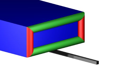

So here's my suggestion for a cheap way to make your own box trailer fairings - buy the biggest, lightweight plastic pipe you can get, cut it in half lengthways and attach it to the front, chamfering the corners:
Before:
After:
I've shown one at the bottom but that's probably a waste of time - it's the top and sides that matter. And don't forget the sides - there's more length of them than there is of the top.

Postby pete42 » Sat Aug 06, 2011 6:57 am
Seems to me your design still leaves a flat front which would act like a barn side for the relative air to hit when being towed.
does anyone have a program we could use to test your theory?
unless someone has a trailer and wants to run a test I would like to see some results would it not be great if it worked?

Postby vreihen » Sat Aug 06, 2011 8:20 am
angib wrote:After:
I believe that you have just created a parachute, but my only experience with aeronautics is of the shade tree variety.
If you want to improve on your design, my $0.02 is to put a piece of plywood over the pipe, cut so that it provides a smooth transition onto the curved surface. Quarter round aluminum extrusions are common on this side of the pond, and are used by trailer manufacturers at the above location on tractor-trailers to join the front and side/roof walls.
Of course, the trailer is a part of the larger aero package that also includes the tow vehicle. I don't like the idea of a "one size fits all" nose cone, since the air exiting the tow vehicle's body is completely different depending on whether your trailer is behind a cargo van, pickup truck, compact hatchback, or sedan with a trunk. You have to treat the tow vehicle and trailer as a unit, and make sure that air flowing off of the tow vehicle interacts smoothly with the trailer.....

I'd been thinking of building something like onto the trailer I end up getting, but your method or using half instead of quarter pipe sections sounds easier to construct. The difference would be the quarter pipe sections could be made to fold flat when not needed to improve clearance between the tow vehicle and trailer.

Postby angib » Sun Aug 07, 2011 1:41 pm
Yes, quarter pipe would work too - though maybe just a little more would be better - like third pipe.
