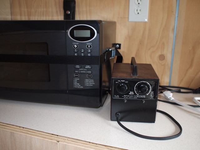

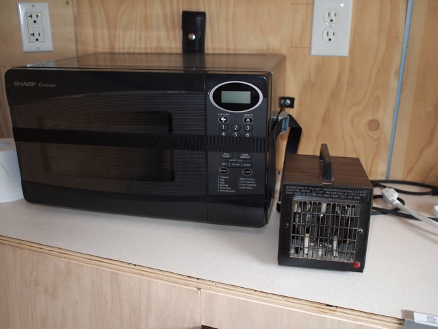

Where do you camp i.e., typically places with hook-ups or more like boondocking? I ask because it makes a difference in heater recommendations. If you have access to 110v AC electric a small electric heater will work wonders and can be left going all night. If no 110v AC electric then gas is the likely option but the "Will kill you thing" is for real.
The pics below show a small electric heater I found at a thrift/second hand store for something like $7. It is small but has a two speed fan and a built in thermostat and runs off of 110v AC. The trick is to find one with a fan built in to blow the warm air around. It is shown next to a 700 Watt small microwave oven for size comparison. It is tiny but puts out a lot of heat, more than enough to keep our 6x10 CT conversion toasty in temps down to 30 degrees outside (that's the coldest external temps we have camped in so far).
The 1st pic shows the front (business end) of the little heater where the heat comes out. The 2nd pic shows the back end where the controls are.
If your CT is insulated it doesn't take a lot to heat it, at least that is my experience.
What we do, if we don't have a 110v AC hook-up, is to go without heat through the night then get up, fire up the Honda EU2000i generator and turn the little electric heater on for an hour or two while we wake up, wash, prepare breakfast, etc. then shut it all down and go about our day hiking, bird watching, etc. When we get back to the CT in the evening we, again, fire up the generator and run the little heater for an hour or two then shut everything down and crawl under thick comforters to sleep for the night. Works for us.

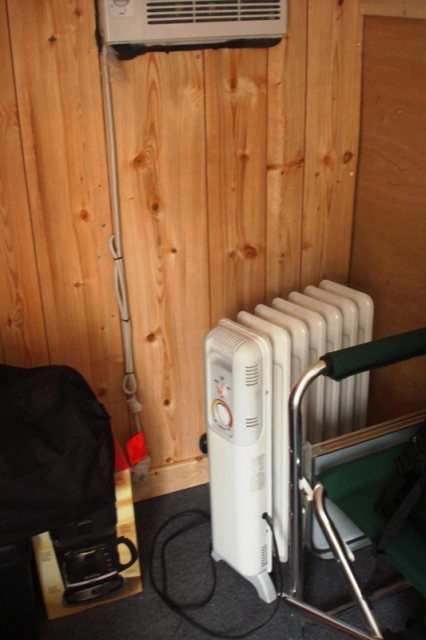

Postby kstephenson » Mon Sep 12, 2011 10:04 am
Here is what I use for heat in my trailer.....works great and wont kill you
