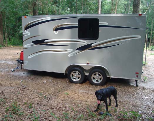

Postby jwhite » Fri Sep 16, 2011 5:37 pm
You may want want to order stabilizer jacks, that was something I didn't think about
but my manufacture suggested them and they were only 50.00 and they are well worth haveing.
last weekend I wasn't parked on level ground so I didn't use them and I could really tell I wasn't useing them.
you can see them in this photo
I lower the front and put down the jacks and the raise the front back up until it's solid.

Postby jwhite » Fri Sep 16, 2011 6:33 pm
Mine fold up and out of the way,well worth 50.00 to spend on the trailer.
