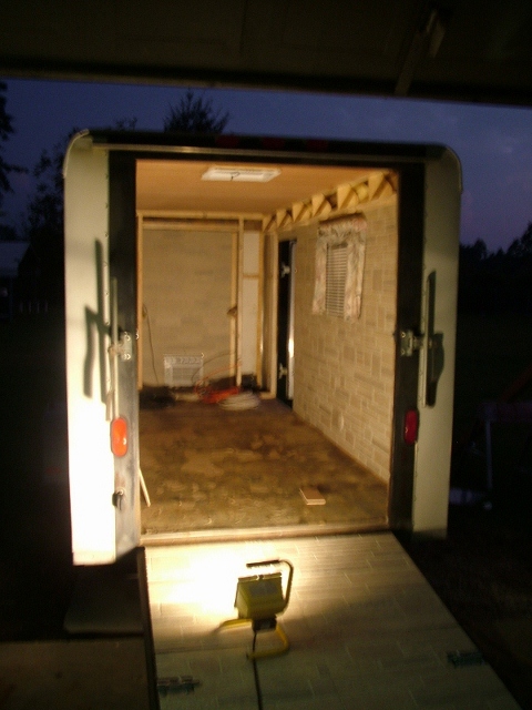

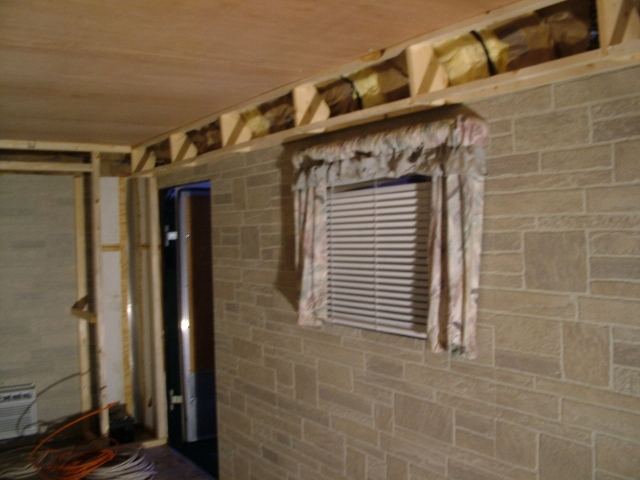

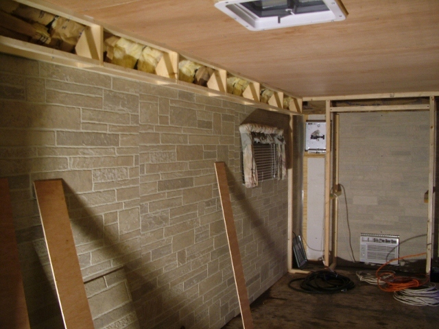

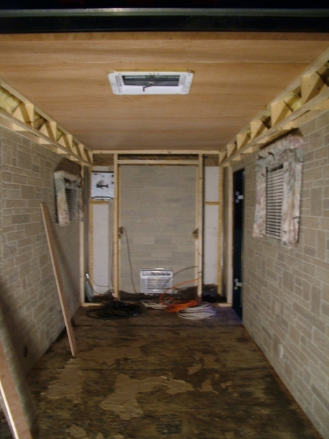

Postby slipperyd12 » Fri Sep 23, 2011 9:29 pm
Insulating was really fun, I started looking at the sheets of foam but my walls are 1 inch thick, Also they wanted $15 per sheet. So I bought the rolls of insulation and did the whole thing for $30. Today was 90 degrees and the insulation worked great. It is time for the electrical wiring.

Postby slipperyd12 » Sat Sep 24, 2011 8:52 am
I have pretty much all of thw wiring to do. I made the top corner enclosed to hide all the wiring.
Four 110V runs, A/C, lights, tv and outside plug. Then several 12V runs ,lights
fans, phone charger outlet. The only problem I have is my battery has to be in the cabinet inside. I guess I will get a box and vent it to the outside. My only delima seem to be can I vent it through the floor or does the vent need to be higher than the battery.
