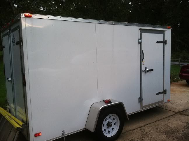

This one's on my local Craigslist for $1350:
The seller says it is 2009 6x12 with a V-nose, "Doors are around 6'. Inside around 7' or more" It looks like a Cargo South logo on the rear door.
Does it look like a 6x12x7' trailer to anyone? I'm thinking its shorter.

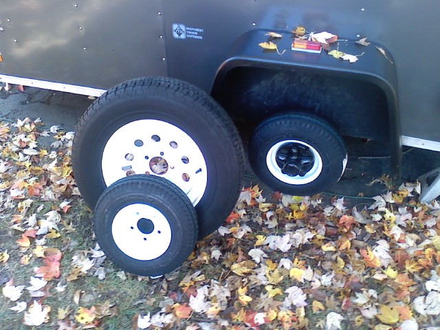

Another member's album shows a set of very small wheels on his CTC that he uses so it will fit into his garage, does anyone know where these wheels came from?
Nitroxjunkie71's album
Thanks!

Kharn wrote:The seller says it is 2009 6x12 with a V-nose, "Doors are around 6'. Inside around 7' or more"
That's not much of a description. I'd ask him for accurate measurements if I were thinking of buying it.
The one in your picture looks like a 12 footer to me. I just took a picture of my 6' X 10' for you to compare. This one is 6' inside height.
Uploaded with ImageShack.us

Postby Trackstriper » Fri Sep 30, 2011 10:48 pm
Kharn wrote:...... does anyone know where these wheels came from?
Northern or other supplier should have something small like these. Make sure the bolt pattern is correct.
http://www.northerntool.com/shop/tools/product_200330147_200330147
