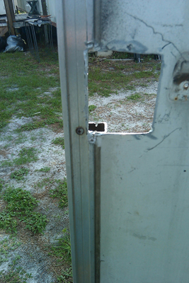

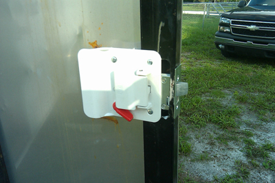

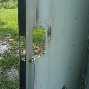

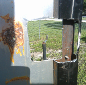

Postby Pyrofish » Mon Oct 10, 2011 9:39 am
As others said, buy the RV door latch, eBay is where I got mine.
The pics in the other thread show a wooden door... CT's don't usually have wooden doors. If you're does, then that should be easy :thumbsup:
If not, it can be a little more difficult. I'm sure my door doesn't represent all CT doors, but here's what I had to do to get mine in:
Ugly, ugly door jam
It took a jig saw, a grinder, a dremel, some drill bits, and a sawzall. It's not the prettiest install, but it's what I could do with what I had. :roll:

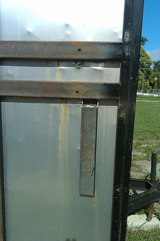

To your other question on the leaving the Cam latch on, that depends. I here on dirt roads on unlevel ground that the RV style door latch can pop open. So the Cam latch can keep it more securely closed. That leaves you with a different problem though. You'll need another Cam Latch Hasp mounted on the trailer side to secure the bar in the open position. Otherwise, someone can lock you in, which is real problem with the crew I camp with :lol: You could also lock it into place with an eye bolt, but I like the look of the hasp, and had the wall open anyway.
I guess if your install is good, and your trailer doesn't tend to twist, the dead-bolt on the RV latch will keep it closed though. I haven't seen mine pop open yet, and I've pulled it without the cam bar.

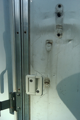

Postby drcurran » Mon Oct 10, 2011 11:18 am
Don't know how this will look, but it is a simple way of locking the large "cam lock bar" open so you can't be locked in. Helps if you have the wall open so you can run the eye bolt through a rib. Good luck!
