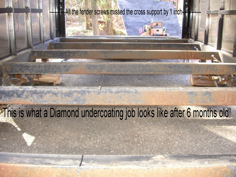

http://tnttt.com/album_ ... c_id=84979

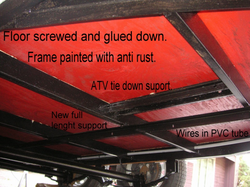

The above link shows my frame after 6 months old, so you may need some type of rust preventative paint for this as well. I used the same paint brand (but different color) on the under side wood because it said it was good for wood too. You should be able to do both with one gallon and have some left over for the studs, etc. Here is a link to the finished underside.
http://tnttt.com/album_ ... c_id=84993
I also glued the floor down with some PL200...this sealed the edges. You may notice that without the floor screwed to the frame that the cross members flex a lot. I ran a extra strip of metal on the underside to act as a cross brace. You can also see I ran my wiring in a PVC pipe to protect it. There are some more pics of the flooring in my album.
