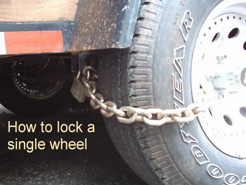

Here is how I lock my single axle utility trailer, but this would work for many of you. Note the hole in the bracket to keep the lock in difficult place to hit with a hammer.

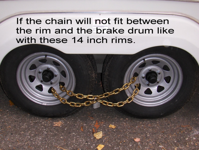

Here is how I had to lock my old travel trailer because the chain would not fit between the rim and the drum.

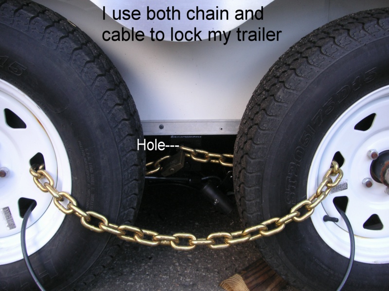

Here is how I lock my Cargo. There is plenty of room to drill a hole for the lock in the mid bracket. Again this makes it very difficult to hit the lock with a hammer. While travelling I only take the cable locks with me as they weigh less. They are big enough to lock up the wheels, bike, gas can and generator if I go away from the camp ground.
