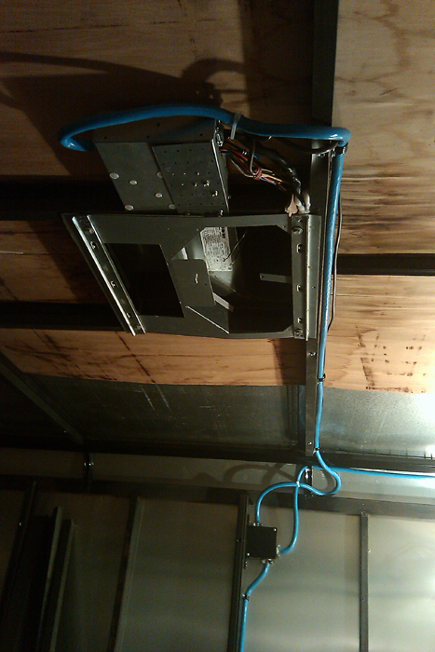

There's alot of folks, me included, that are using extension cords. I calculated that 10/3 would be nice to have in my toy hauler with the AC and 45 amp panel. When I looked at 10/3 romex, well, I wondered what else I might try :shock: I picked up a 100' 10/3 extension cord with a triple end from eBay for $60 delivered. I only used 60' of it, so now I have a 40' 10 gauge extension cord too :applause:
The blue wire in the image is the extension cord. The sheath around it is very robust and much more difficult to penetrate than Romex sheathing.
If you're doing a smaller build, any old extension cord will do. I had an old 12 gauge laying around with both ends cut off. It had an abrasion in the middle, so that's how a jobsite safety guy will "disable" your cord for you at the Space Center. I've used it all over the hauler for wiring on outlets and such.
