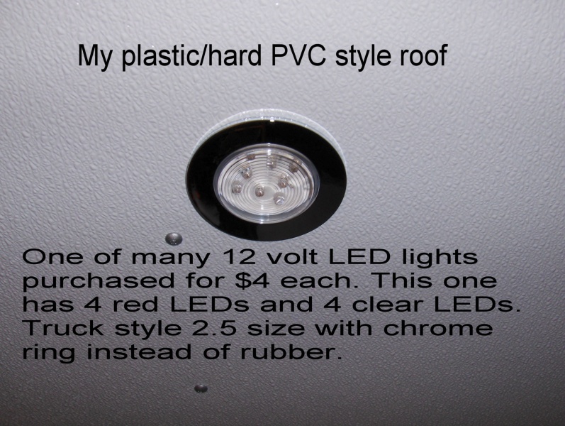

Postby BC Cargo » Tue Jan 31, 2012 1:32 pm
http://tnttt.com/album_ ... c_id=85105
I used a plastic type bathroom product that you can find at a big box lumber store. It was a little pricy at $55 a sheet but I spent the big bucks as my trailer is only 6 ft high inside and I thought this would be easily cleaned from hair oil…(that is If I had any hair left). I also thought I would be real smart and use double sided foam tape to stick it up and provide a thermal barrier to the steal. Then screw it up as well. The white double sided foam tape worked real well for the install, holding it in perfect place while I added a few screws. It also did a fantastic job on the seams that I overlapped. However the plastic panel does not span the 24 inch centers that well and the foam tape makes the panel bulge a bit in the sun as it does not let it move. I would not use it again unless it was on 12 centers, and was allowed to float with holes larger than the screw itself.
I would try some type of thin pre-covered vinyl plywood and if you have room spend the extra buck and strap it on 12 inch centers. I would install the foam board the thickness of the steal rafters, then strap it, then run the foam the other way filling in between the strpping. This could also make it easier to wire lights onto the roof as you can go through the wood strapping with holes if required.
